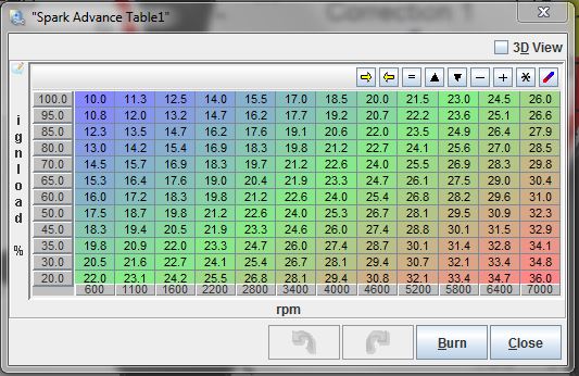

The engine started up on the first twist of the key & the TunerStudio 'Autotune' feauture called VE Analyze Live works well! I'm sure I can get the mixture correct - but I am researching the ignition advance map still:
Does this look reasonable for the engine?
- sparkAdvance.JPG (64.13 KiB) Viewed 10797 times

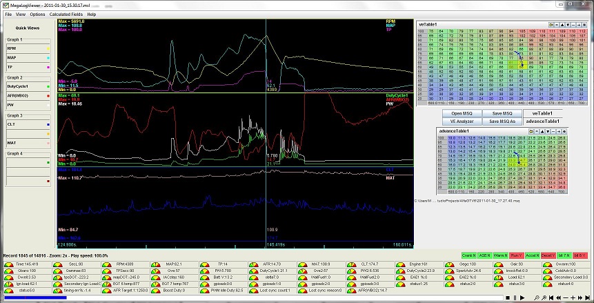

Here is a screen shot from mega log viewer showing a tuning run. One can update the map offline using the feedback from this tool... or Megasquirt will update it itself using Tunerstudio. As example, at this moment the AFR is 14.7 which is too low for a max throttle run.
The current MAP showing which cells are active inthe AFR and Ignition maps are also shown.
