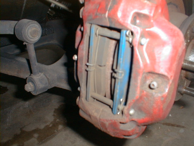

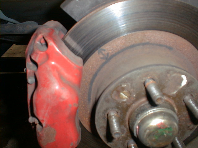

Ok here are the pictures. In the first one you can see the lines I drew to show where the calipers are not grabbing.
The second picture shows the tops of the pads which are above the top of the rotors.
Here is the next picture, it's a little tough to see but trust me, the pads are way above the rotors.

MR2 Zig, these calipers are not the floating type, I dont' think the pads will hang up unless they get stuck at the top where they overlap the rotors. Still, it's a concern so thanks for pointing it out. Keep in mind, I drove the car, it stops well. My concern is increased brake fade because less area on the rotor is clamped. The pistons are well positioned and I don't think they will be able to tilt in the bores
I see that in the photos that there wont be the function problems that I mentioned. I thought things were worse than that.
It may be a good idea to see what rotor diameter will fit. Measure the disc to the top of the pad, add about an eighth of an inch, times 2 , plus the diameter of the rotor, and you get the latest big brake upgrade 8)
