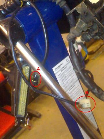

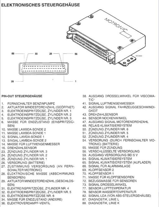

However I don't have the part of the harness that goes to the box in the trunk. The only connection to the alarm / immobilizer I can find is one cable connected to pin 66 of the ECU. It's yellow / black and you can see it marked with (B) on the picture.
According to the ECU pinouts in 164 Q4 technical bulletin it's "signal für alarmanlage".
I have both tried to leave it unconnected, ground it and connect it to current (through a 1A fuse) with the same result; no spark.

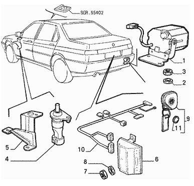

number 6 is the box that you have to remove...but i don't know where the cable that is connected to the box corresponds to which ecu-pin :(
i have a 164...buth with the immpobilizer biuldin in the ecu...
