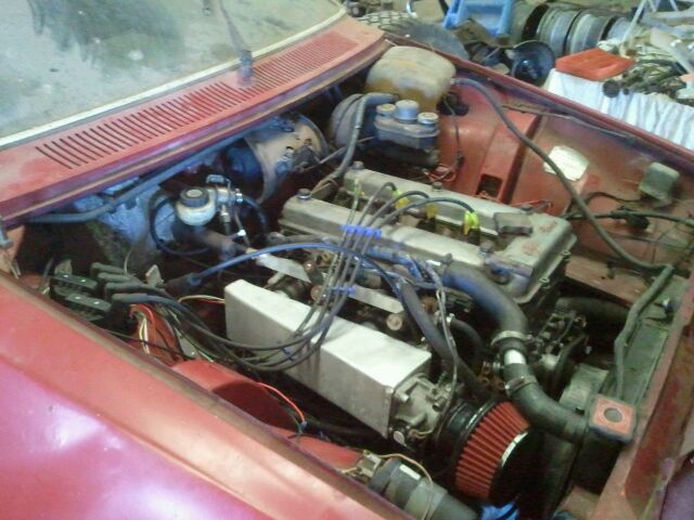

I converted the '77 to EFI - years ago I was so sick of the carbs playing up at the track that I decided I wouldn't take it out again until it was fuel injected.
Having a total budget for the upgrade of roughly nothing, the conversion consisted of what parts I had in the shed, whatever I could scrounge from friends/wreckers/ebay, and the rest I'd have to make myself.
I'd had an L-Jet spider manifold and plenum tucked away for this project, but once I fitted it to the head I found so many problems with the setup.
With the injectors being low impedance hose tail units and the plenum pointing the small throttle body over the fuel rail towards the exhaust - and the thermostat housing interfering with mounting an o-ring injector rail.
After trying unsuccessfully to work out a way to make everything fit, I gave up and made a quick plenum for a holden v6 throttle body, and knocked up an o-ring injector rail with extra-long bosses to clear the thermostat.
Next was to do away with the distributor and switch to DFI so added the required slots to the balancer and re-purposed an old ABS sensor as a CAS
The ECU is an old GM unit with some modifications to the hardware and firmware to make it more flexible, the loom was from an early 90's Nissan Pulsar (which ran a GM ECU here in oz), the ignition setup is from a similar vintage Chev something-or-other, sensors are a mix of Bosch spider and junkyard GM, and the injectors and FPR are off a late 80s saab 9000 turbo.
It looks like crap, but it all works together very well - and the whole setup owes me less than $300 so I can't complain ;)
