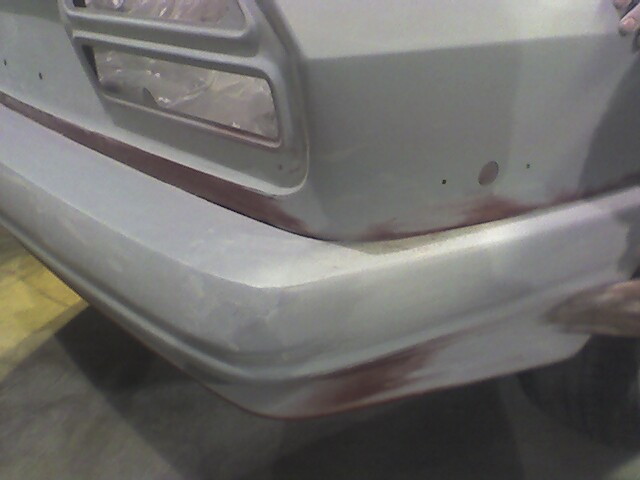

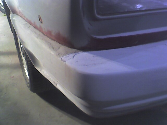

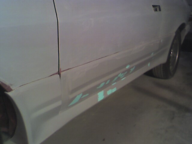

Well had to go work on the Alfa today. I am addicted. :P Things are right on track for the body. After the initial primer we decided to prime with a special rust primer to the areas that have the problems with rust. We also used this primer under the whole Zender Kit since the body kit covers alot of the panels and mosture could collect here. This could cause additional rust problems in the future. I really did not do this before, but my associate said we might as well do it correctly since we are spending a lot of effort on making the body correct. Why take a chance. Were the body kit was screwed into the panels we filled the whole chanel with filler and sanded it smooth instead of putting the door strip that most Zender Kits have. :) We also took a lot of time making sure that the rear bumper lined up perfectly with no gaps. Needed to build up the fiberglass edges and then sand down as needed.
We just need to put the front bumper on and sand a lot more and were ready to spray. Its taking a little longer than expected for this step but the preparing work is the most important part. The pictures can not show it but the car is very smooth. :)
Here are some pictures of my progress.
Alfa Primer Rear Zender Kit #5.JPG (43.35 KiB) Viewed 9569 times
Alfa Primer with Zender Kit #2.JPG (67.89 KiB) Viewed 9569 times

Here are some more photos for everyone to view. We are just hoping that no one hits the bumpers. We have the brackets in place but before these will protect the chasis the Zender bumper will be trashed. :( This is the only thing we really do not like about the bumpers. Of course this system is alot lighter.
Alfa Primer Front Zender Kit #8.JPG (62.99 KiB) Viewed 9568 times
Alfa Primer PSG Side Zender Kit #6.JPG (35.68 KiB) Viewed 9568 times

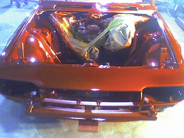

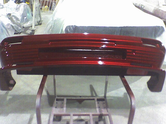

We decided not to install the front bumper first but to paint it first. The reason being is that we wanted to spray the front part under the bumper as well for futher rust protection.
Here are some more pictures. :)
Alfa Front Bumper Painted #8.JPG (78.41 KiB) Viewed 9466 times

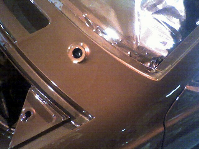

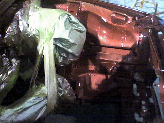

We were happy that there are no more moldings on the side. We think it make the for a cleaner install on the Zender kit and it appears to be factory installed.
More Pictures: :D
Alfa Engine Bay #15.JPG (96.84 KiB) Viewed 9461 times

Alfa psg side painted #12.JPG (64.14 KiB) Viewed 9459 times
Alfa dvr side painted #11.JPG (79.97 KiB) Viewed 9460 times
