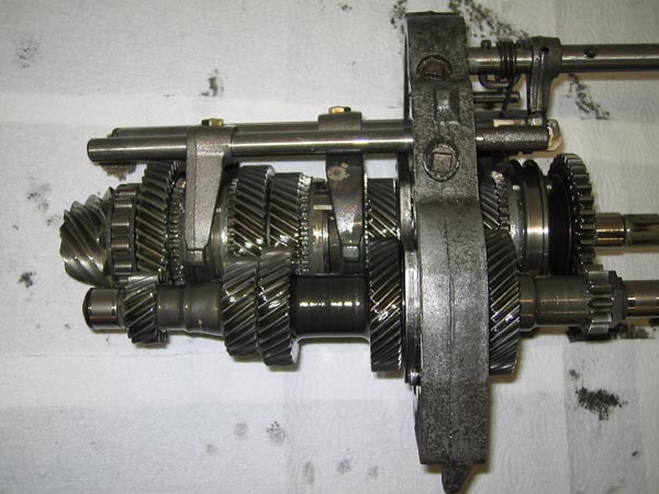

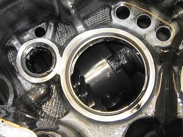

Now we´ve taken the gear box appart (TS-box) and discovered what the problem is. The pinion and the crown wheel hasn´t been friends for a while. (see pics below)
What we´re thinking about now is this: We have an extra gear box from a 2.5 i good shape. Can we combine these two and build one healthy one? We would like to take the pinion and the whole package in the middle pic. below, and the crown wheel from the 2.5 box and put it in the TS. Will this work?
Another idea is to take the diff from the TS, change the crown wheel and put it in the healthy 2.5. Any thoughts?
The pictures shows the damage om both crown wheel and pinion.

Some feedback for you. After taking the old gear box appart and noticing it was a gonner, we did as follows:
We took the diff from the box we had, a TS. It was still ok, but the pinion and crown wheel was wrecked. Then we took the gears and crown wheel from a 2.5 and the cluch we kept (from a 3.0 originally).
Now it has been but back in the car and it works well after all we can tell after a few test drives.
So, it works combining different trans axle gear boxes! :P

about the old box..the one on the pics that have pinion and crownwheel damaged....
when you fit this ?, or how time(or track days) before noise begins to appear ?
were i want to go with theses questions.
i want to know if vital clearances are checked and eventually adjusted.
its important to set the pinion to crownwheel play with the shims beetwen differential bearing race in cover and case.
and one other clearance:
the pinion heigth., translate to the contact 'aera' beetwen crownwheel and pinion theets...
