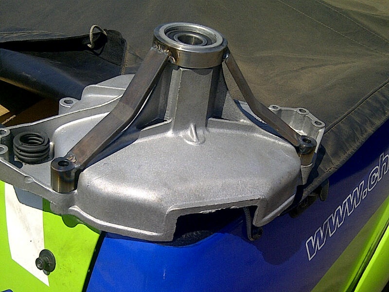

The clutch housing is a weak point especially on Tarmac rallying as it takes more abuse than the track . I do know of three to four housings that broke due to balance issues on prop , bad bearings in housing and these were not even on high horse power motors and revs were at max 6500pm . Some of these were 2.0 and others were v6 . . If you reinforce housing and do all what you mentioned above you " should" be ok . Md showed us all how to reinforce housings which I copied and worked very well on my 3.7 and is currently on another 3.2 with a twinspark gearbox . Also check the sleeve in the top of housing is not worn or loose .
Once you have assembled clutch into housing check for play . ( hold one section in vice )
Did the housing break suddenly on a down change into second or a change up between second and third .
- image.jpg (155.45 KiB) Viewed 17371 times
- image.jpg (163.9 KiB) Viewed 17371 times
Re: Balance issues?
I'll have to check about the timing of the breakage. Thanks for the photos, Kevin - I'll certainly be recommending reinforcing the unit.
