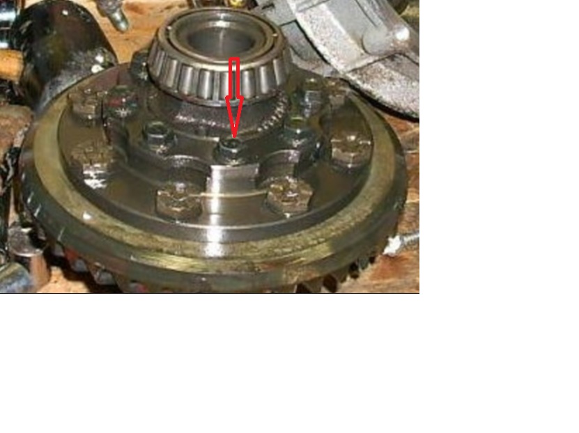

Does anyone know the torque setting of the LSD bolts for a 75 TS box ? (see arrow in attached photo)
I cannot find it in my manual...
Thanks !

I'll check my workshop manual. If in doubt, use standard tightening torques. Can't remember if that is 10.9 or 8.8 but it's an M8 right?

OK, thanks for checking Mats.
Yes, it's M8.

2.7kgm
