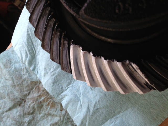

I am trying to rebuild a Platinum transaxle right now. On disassembly, I discovered that the pinion shim was badly worn. I found some shims from the Nissan parts bin that are close to the correct size. The shaft of the pinion is 1.1735in on the spot that the shim rests. The original shim has an ID of 1.1840in. My new Nissan shim has an ID of 1.1915in.
Does anyone think my Nissan shim is too sloppy on the ID? I sort of think that it isnt so important, since the load is on the face of the shim.
Anyway, I have had the Nissan shim surface ground to a thickness of .081in. I arrived at this number by measuring the original shim and finding it to be .070in. I thought I would start on the large side, since I could always have more material removed.
The photos show the pattern on my ring after installation of the ground Nissan shim. I am not experienced with setting these up, but it looks to me like the pinion needs to go deeper into the ring, meaning that my .081in shim is too thin.
Please let me know what you think. Sorry for giving measurements in inches, I am dealing with American machinists and inches are what they prefer to talk about

Re: Pinion Depth
I agree.
I also strongly suggest that you get shims that are ready made and not ground. If you grind the surface the hardening is lost and it will wear fast.
Get a set of shims so you can try different heights, but you are VERY close to the correct height so no huge steps needed. You do however need to torque everything down or you will get a different result in the end when everything has settled.
Also, when you move the pinion further towards the centre of the diff you will also move the pattern on the coast side...
To get everything "perfect" you need to set the backlash (crown gear height) too, BUT you should of course focus on the drive side.

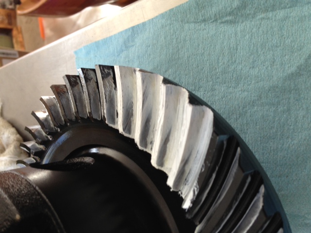

Re: Pinion Depth
I checked the pattern on my spare Platinum ring and pinion...
It looks to me like this pinion is set a little too deep. I am disappointed because I had hoped that it would look better. Both of my Platinum transaxles came out of working cars that I drove. I noticed nothing amiss with either of them (aside from worn out synchros). Is it common to find these things set poorly? It might explain why some people consider the ring and pinion to be a weakness in these cars.
Im working, once again, on sourcing some shims. If anyone knows a source that will sell to individuals (not manufacturing companies), please let me know.
- photo (5).JPG (110.11 KiB) Viewed 13483 times
- photo (4).JPG (98.77 KiB) Viewed 13483 times
Re: Pinion Depth
That's the coast side. What does the drive side look like?
And by the way, the pattern looks spot on to me.
Re: Pinion Depth
Top photo shows the drive side. It looks to me like the contact is a little close to the toe, though I could be wrong as i am not experienced. If it is too close to the toe, does that mean I should adjust backlash and/or move the pinion away from the center of the diff? (Not that I have any such capabilities without the correct shims).
Mats,
If you think that I am wrong and the drive side looks acceptable to you, please let me know. I would love to forget about all of this and just run it.
Mats,
Re: Pinion Depth
Top photo did't show yesterday actually... The forum seems a bit slow lately.
I agree, too close to the toe, I was looking at the coast side.
