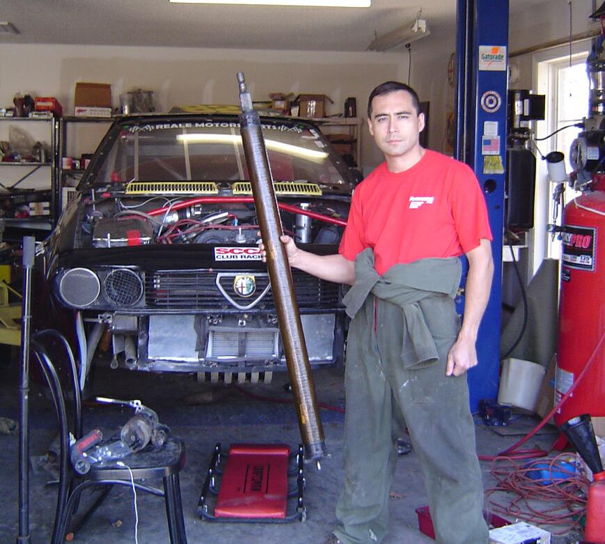

CF driveshaft pic
Ok,
as requested, here is a picture of the driveshaft. It weighs about 10 lbs.
When I get time, I will put up a page on my website with pics of the shaft in its natural environment, as well as my shift linkage.
-Al Mitchell
-Al Mitchell

driveshaft
Ah, now we are making some progress.
Some close ups of each end of the shaft illustrating the detail would be nice with an explanation of how the concept works and to what degree does it work well?
What are the drawbacks (if any)
How is it fitted? How much power is it designed to handle?
(just for laughs) I am glad that thing hasn't got hair on it or it would be a real weapon!!
CF shaft
Heh heh, yes you can tell an Alfa guy by the size of his driveshaft.
Ok, I will take a bunch of pics, but I am trying to get the car ready to go to a race at Moroso next weekend, so things have been a bit hectic.
Before we all go out and get one, lets make sure it doesn't fly apart after X hours of operation.
Someone mentioned earlier about the elimination or modification of the flex couplings, and I would be interested in hearing specifics.
The length of our driveshaft makes going to a one piece assembly complicated, since a steel or aluminum shaft would begin to "whip" above a certain RPM. Since we have the privilege of an engine RPM driveshaft, this is a big problem. We have some pretty good data that suggests that a one piece steel driveshaft will NOT work.
I know some guys that tried U-Joints, but they did not seem to hold up to racing use-but I would like to hear other's experiences.
Anyway, this setup uses the front end of the GTV6/Milano driveshaft, and the back end of a late Alfetta. Why? Well, the Alfetta rear donut has its spherical pivot integral to the donut, as opposed to the GTV6 arrangement,and we have data to support that it can handle over 300HP. My transaxle is shoved up into the tunnel pretty far, and the stock donut probably would not fit, as well.
I have found that the shaft is VERY sensitive to the alignment of the engine and transaxle. I still have not managed to get the engine and transaxle to exactly line up. In fact, I was appalled at how out of alignment the two were when I started. Anyway, I am working on some adjustable engine mounts, and for the interim have shimmed them into approximate alignment. I experience a small vibration at 1800 RPM, and then (oddly), nothing until about 7000, where there is another smaller vibration. This vibration has decreased as I have tweaked the alignment closer and closer.
My recommendation is that we wait until I get them exactly pointed at one another, and tested out, before we all run out and spend $1500 on our own.
Ok, gotta go put the airdam on.
-Al
