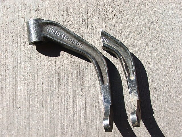

MD, what did you make the distance of the gearbox crank/arm centre of the splines to centre of the welded on rod?

Duk,
Not sure I completely understand the question. I am assuming you want to know the final length of the cut down crank. If that is the case, that would be about 45% of the original.

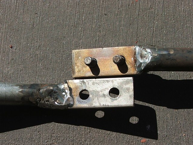

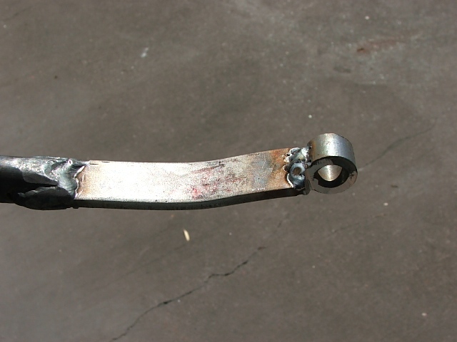

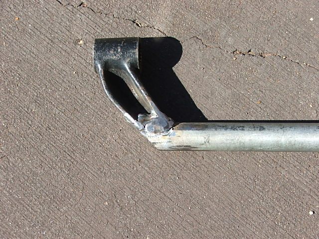

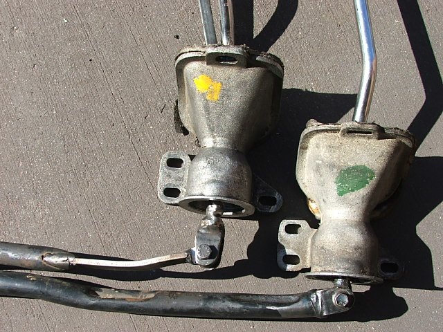

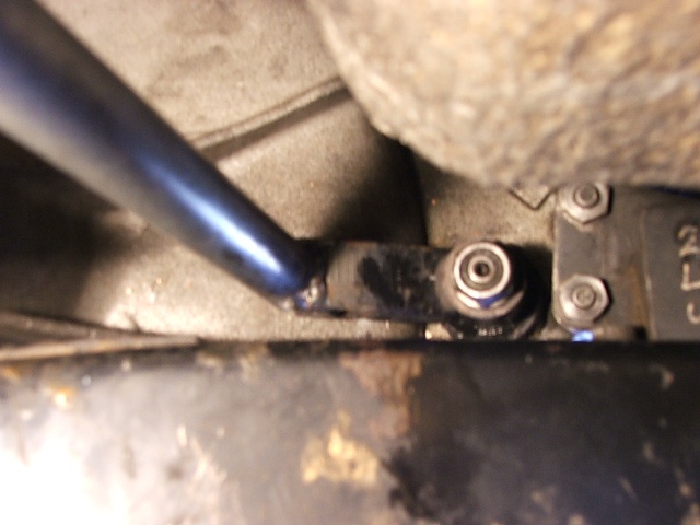

Here's some more photos of the mods start to finish. Hope they are self explanatory. Involves some trial and error for fit.
I think for your puposes not having to be concerned about a console, you should do the modification suggested by Daniel which will give you a greater length extension without fouling the driveshaft.
Duk,
- A.jpg (116.31 KiB) Viewed 13051 times
- B.jpg (97.93 KiB) Viewed 13051 times
- C.jpg (115.81 KiB) Viewed 13051 times
- D.jpg (98.78 KiB) Viewed 13053 times
Re: Short Shift
..a few more to complete the sequence..
You can see that moving the base up on top of the tunnel say 20 -25mm means you dont have to do a fulcrum conversion and shaft thickness reduction to clear the cross member when extending the shaft under the main fulcrum ball.
- E.jpg (118.75 KiB) Viewed 13050 times
- F.jpg (119.75 KiB) Viewed 13050 times
- G.jpg (92.4 KiB) Viewed 13052 times
Re: Short Shift
Sorry mate, I shouldn't go foruming after nightshifts, I may as well be drunk sometimes
The length of the splined arm in the last 2 photo's you just posted, preferably from the centre of the gearbox input shaft to the centre of the rod you welded on.
Good to hear that you 'nana benders and hopefully your Alfa Romeo's are okay
