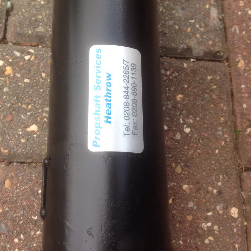

Z , here is name of guys who can make a replica Alfa prop with torsion resilient tube and universals . They said when I was at their shop Itbwould cost about £450 . You then need to make adaptors to flywheel .
However ... Just use the coupling cage on std prop with new front coupling , BMW centre coupling and Alfa rear with cage when you break something let me know but I doubt you will . Save a lot of time .
