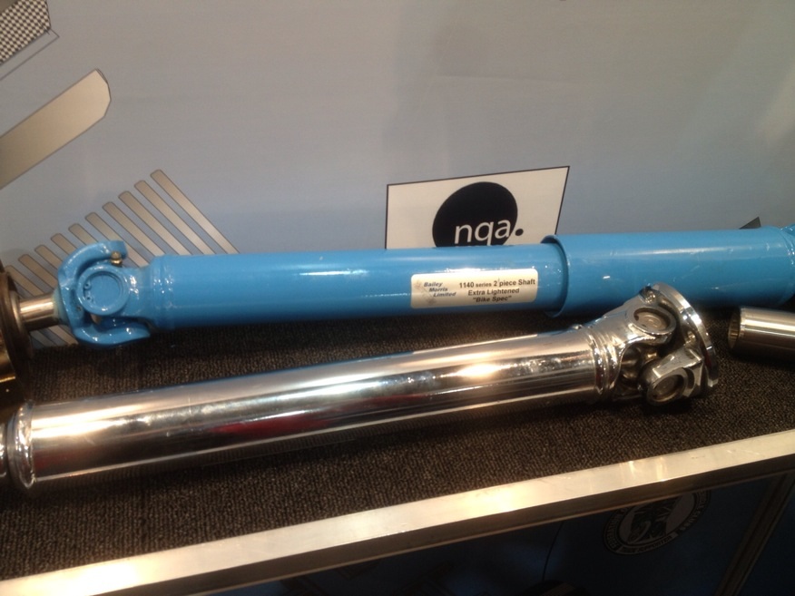

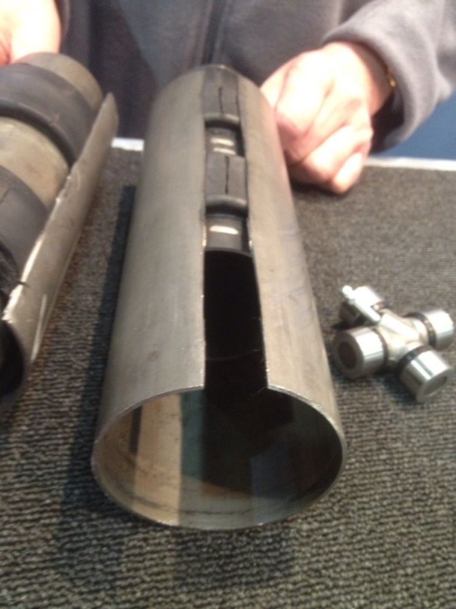

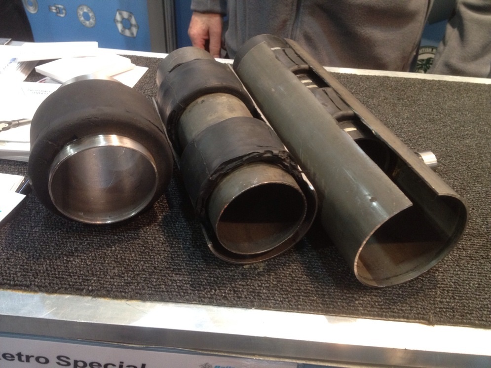

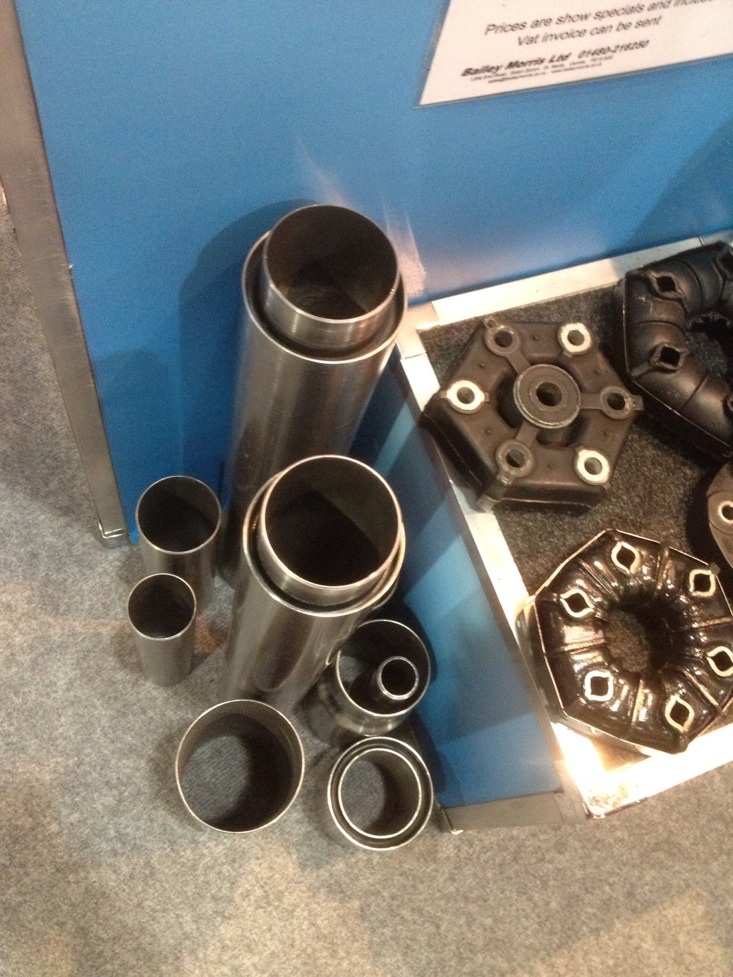

MD , thought I would post some pics of a torsion resilient propshaft tube that's used on Aston Martins etc ( and my car ha ha) . These cut away pics show rubber strips which are bonded to the inner tube . The outer is compressed over this with severe pressure and friction creates the bond to the outer . These hold up 1000nm easily . They are different size tubes for different applications . There are a few transaxle GTV running this set up with no couplings but just using this bonded rubber to absorbs all the harmonics .
Even with a copper clutch I don't have clutch shudder in my race car . Think it was just luck that mine turned out perfectly .
Some pics explain this concept better of steel tube within a tube .
The blue prop is for a marina but its same size used on the GTV .

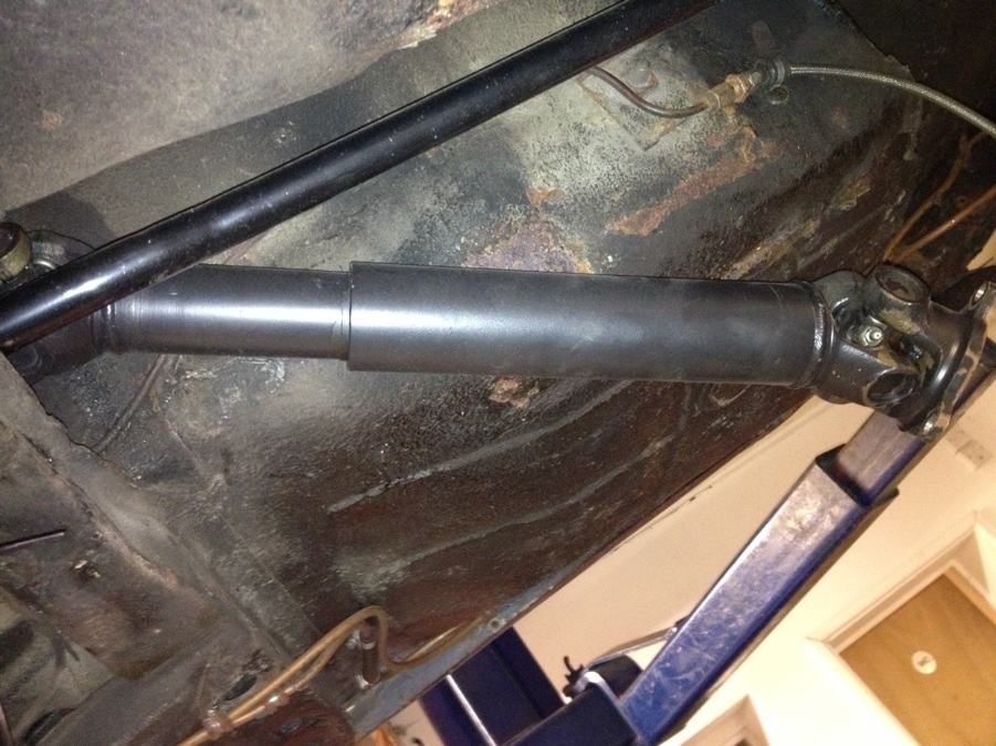

Re: driveshaft conversion
You use this set up when you're racing with big power and very high rpm and you're not taking and chances with rubber guibos ( doughnuts) . Or even simply an 8000rpm 2.5 screamer . You normally run three universals with this set up . This pic is on the GTV and has just the last section with the torsion resilient tube .
