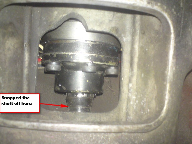

What can I say? We are brothers in the pooh (again). I have used your photo to illustrate where my shaft broke using the same basic set up. Not only did it brake the shaft nose piece but made a 50mm hole in the side of my rear engine mount that I especially imported from Holland. Like I am overjoyed. In my case it is a inadequate accurate balancing. We just don't have the gear here to do a proper job on these shaft together with metal fatigue caused by
the crappy balancing. I tell ya, I am spitting chips..
..harder than Clint Eastwood.. that's gold Mats.
- Pete's coupling used for example.jpg (58.86 KiB) Viewed 9058 times

Yes there is nothing wrong with your suggestion. However I have tried every kind of rubber front coupling from genuine Alfa, BMW, Mercedes and our local GM car, the Commodore (Opel equivalent)
It chewed them all up. I than installed the coupling in a metal shroud. It pulverised the coupling inside the can and I am still pulling threads off the chassis from time to time. It also turned the metal shroud into a squashed soft drink can.
By then I have had the total shits and decided to go all CV. This was fine for about 4 meetings and then the front of the shaft snapped off. So at this stage, I am thinking I need some matches, you know, the fire starting kind...
No, all is well but it really comes down to how much luck you get with our balancers here.Mostly they couldn't balance a 20 cents piece on the end of a hard on.
