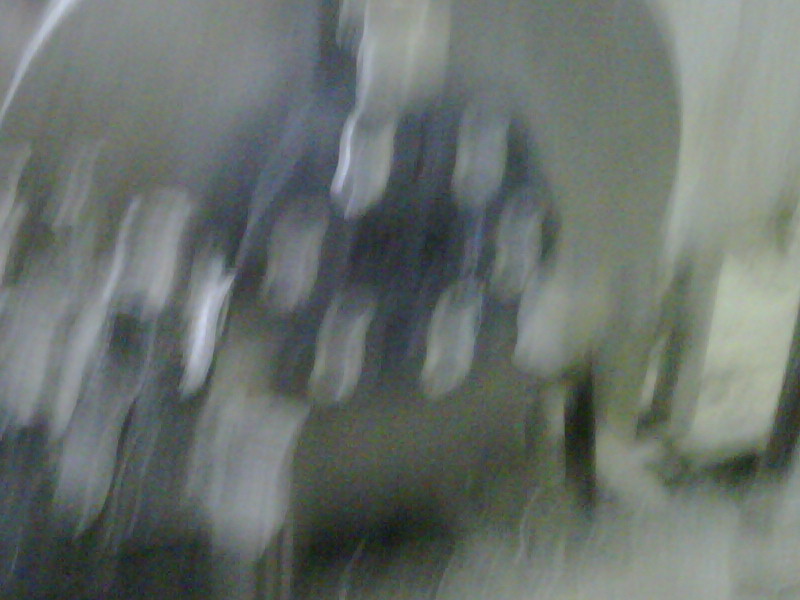

I did try to grind or cut one which proved to be impossible as there is a hidden steel tube undre the surface which in lathe creates havoc. I then tried to machine one - still no joy . see pics
- Imported Photos 00066.jpg (94.28 KiB) Viewed 15196 times
- Imported Photos 00070.jpg (182.22 KiB) Viewed 15198 times
- Imported Photos 00068.jpg (125.03 KiB) Viewed 15199 times
Re: middle guibo
Sorry they came out so big but the top one is not really blurred its just that the rubber jumps all over the show thus i tried machining it next. It did actually come out the lathe and hit the far corner of the workshop at good pace. It could have made an interesting print on my forehead
