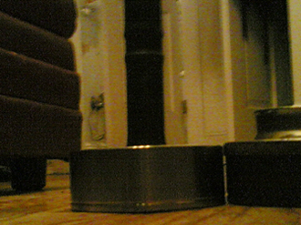

!here is one i got off ebay. the thing is you need to use the 930 boot and flange (which run about 10-20$ a kit). keep in mind that i paid 170$ for a set of 4 brand new (made in germany) joints. lemme post the link, bc i think this guy always sells them on ebay.....

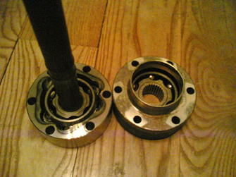

i can only take pictures with my cell phone right now, so pardon the quality. about 1/4 inch in from each end of the alfa cv joint there is a machined groove to accept both the end cap and the boot flange. on the porsche cv there is only one groove machined on the circumference of one end. The side with the groove gets the the end cap. The side without it receives the different type porsche boot and flange. in the picture below you can definately see that the new porsche joint on the left has only one groove. the alfa joint on the right has two. you cannot see one because the alfa boot flange is on one end and the one on the bottom is just blends in with the rusty metal.

I think the boot issue turns out to be the other-way round; you must use the Alfa boots and flanges on the Porsche-style joints.
I took a closer look at my collection of used cv joints, and found that most of them only have the groove on one end. A few have two groves, but I don't think it makes much (if any) difference in how the flange or end cap fit. Both seem to fit just fine with or without it, at least for the caps and flanges I have on hand. It does appear that on joints with one groove, the end-cap is on that end.
The Porsche-style boots and flanges, on the other hand, while really nice unfortunately have clearance issues. At least at the outboard end, with the springs, and possibly at the endboard end, at extreme suspension travel. They start out a larger diameter at the flange, and don't taper at all, which leads to the fitment problems. It's a shame, because the are very well made. The flanges are works of art, and the boots feel like they are made from a much thicker, tougher, material than the boots I've been able to find in the Alfa style. Oh well. Hope this info helps others.
