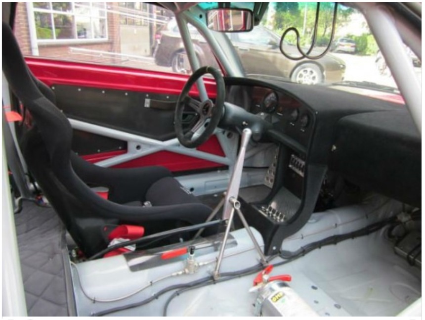

Just moved this pic from another section for discussion .
This seems a pretty simple set up . Looks like a fair distance from the spherical bearing to where it bolts onto the linkage bar to shorten the change . Pity I can't find any more pics where it joins up to the box .
MD whadda ya guys think down under ?

Yes I am very pleased to see an effort with some lateral thinking happening. Straddling the tunnel should help with tunnel flex which is a problem. I know of a certain guy who prepares rally Alfettas and uses a "double tunnel" technique to stiffen it. This is done by cutting a section out of a donor wreck and welding into the car's tunnel. This effectively firms up the shifter base which has a tendency to flex. I do carry out a stiffening as well but a different approach to both of these.
The length below the fulcrum on the shifter base seems about right and should reduce shifting throw. The dimensions of the shifter body itself is a good generous proportion and will eliminate the flexing of this component. Good stuff.
So in summary, throw and rigidity have been well addressed.
However, the actual components that make such a system work are not visible and therefore I cannot make a worthwhile comment that is much help in order that others could replicate this with success.
From what I do see in that the way the selector shaft is connected to the shifter base, it does not lend itself for smooth and correct selection. It may work up to a point as I have made version using similar arrangements but the shift is baulky- especially into 2nd gear.
So my apologies to the person who actually owns this vehicle if my observations offend. If anyone knows the full details of the make up and provides some photos of same, I happy to retract my comment.

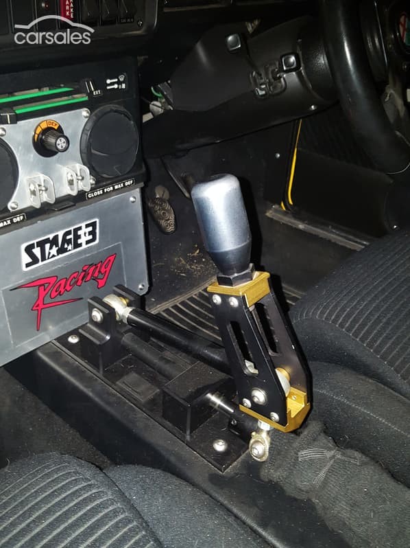

Hi guys. Long time since I visited this topic. Come across this set up in a local advertisement of an Alfetta GTV 2.0
Anyone come across this before? Is it a commercial set up ? Is it a home brew?

Looks nice, but I haven't heard of anyone manufacturing anything shifter related for our cars.

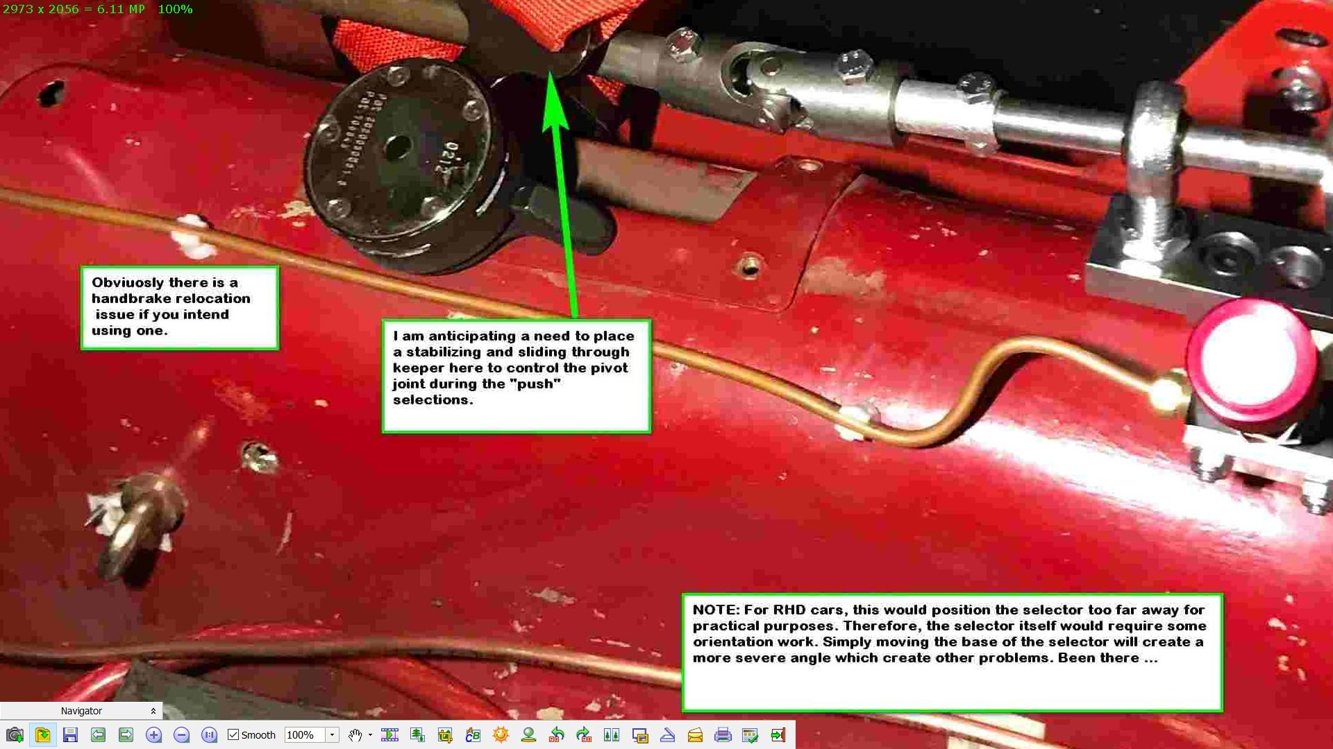

As this will be the final modification that I have planned for my 24V project, I was thinking of doing something along these lines;

Peter,
See notes on photo
See notes on photo
