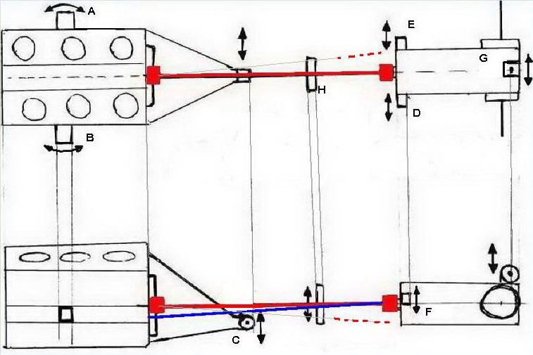

Since we had a driveshaft breakage just behind the splined section, with my 24v engine in my mechanic's 75, I decided to try my hand at laser-aligning the driveshaft when the same engine was installed in my 75. What I basically wanted, was to see the red dot on or very close to the center of flywheel and gearbox flange. The first test was eye-popping: you can see the dotted red lines in the drawing! Everything was way off! Left/right centering was accomplished by widening the top/bottom slots in the motor mount plates (A,B) and by juggling the engine around until the red dot at least was in the middle. Then, the up/down movement was accomplished by putting spacers under the rear engine mount (C).
The gearbox on the other hand, pointed very much to the right (~50mm) and considerably lower (another 50mm) from the flywheel center. Raising the nose of the gearbox was accomplished by reducing spacer thickness to 8mm (from 15mm). These spacers are only used in 1.8T and V6 cars. Left/right correction was by making the gearbox mount (D,E) holes larger and by juggling around, tightening bolts in the correct position. Since the nose of the gearbox tends to rise under application of torque, I decided to have it point ~15mm lower than flywheel center, thinking it will 'align itself' when in motion (blue line). All considered, there is much less than 1* misalignment now with this intentional gearbox 'trick'.
You understand this is all 'seat-of-the-pants' stuff...
I used the 1.8T driveshaft, no splines and no solid center donut. I thought if 450hp dragsters get away with it, I should be ok too.
We'll soon see if all this was worth the time!

Great write up JK. I've always wondered about the misalignment.
When I was at the balancing shop the owner always reminded the apprentice to make sure the shaft is placed properly in a straight line on his jig. Then he has many runout gauges. He balances by making sure the runout on the shaft at many sections are not excessive, AND he also measures the imbalance and fixes that. So it's not about adding or subtracting weights, it's also the "true-ness" of the shaft (ok the yokes/flanges need to be good too).
So this always had me wondering, if the balance shop had to measure the true-ness of the shaft, how the F can this shaft spin without vibrating when the whole setup on the car is not even proper, the shaft is skewed and the guibos are in compression and tension at the same time. Fer Chrissakes, it's not even worth the balance job until the setup on the car is aligned! ...well at least that is my opinion
BTW don't you think the center bearing mounts needs to have some adjustability as well?
I have the laser tool so I will check the whole thing again. BTW did you do this on a lift or on jack stands?
Z
Z

The car is on a 4-post lift so its actually ...parked!
The middle support required only a couple of washers to center so that was the easy part. I hate to think what I would do (and how) if it needed raising...
I assume I will have to balance the driveshaft on-car, but thats no problem as there's a shop here doing a very good job of that. They did a great job a few years ago on my other 3liter.

In a 75 it must be so much easier as you at least starting ofwith engine mounts that are symmetrical unlike the huge offset type in the GTV .
In my gtv rave car I have zero vibrations and have
1) bolted gearbox mounts
2) aligned engine with lazer to gearbox thus had to make new engine mounts
3) the new engine mounts then forced me to make NEW bell housing bush as existing is offeset by 15mm .
4) the new bell housing bush and engine mounts then forced me to remake bolt hole position on centre carrier bearing as it's also offset .
5) NOW that engine was all aligned I had to make engine stay to keep this all in alignment under acceleration .
Whew - what a job as engine had to come out with a spare block to align laser up through centre of crank position.
I have had to put reference marks in engine bay - so if I take engine out I can always recheck it's in line x and y direction
Bottomline - it works for a race car and the only vibration I feel in car is from the mogul gearbox oil pump cooler
I hope it's much easier with a 75
