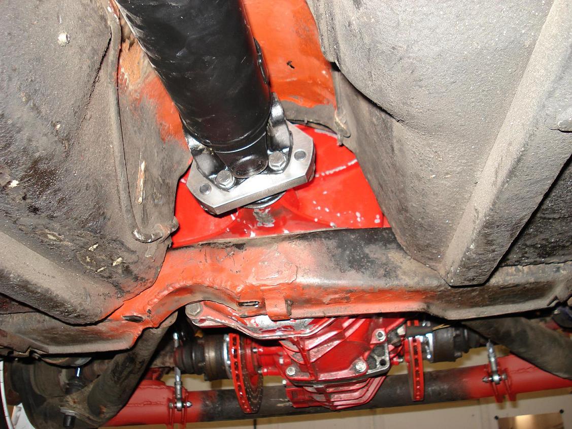

Here is a picture from the back of my shaft. The front has the same type of coupling as the back and is attatched to a 3.6kilo alu flywheel.

Jarle,
Tell us what we all want to know:-
1 Is it all universal joint or a mix of rubber couplings as well?
2 What car is this on, road or race ?
3 Two piece or one piece shaft?
4 Is the vibration (if any) acceptable?
5 Is there any special fitting requirements in terms of angles to cater for the correct operation of the universal joints?
Hope it's not too many questions for ya.
Jarle: Don't tease us with one pic!!!
Jarle
Posts: 88
Location: Norway
Post by Jarle »
MD:
1: No rubber
2: Track car with licence plates
3: 2-piece with slide part in senter section
4: Acceptable. Engine is fully rebalanced with front pulley and "front" flywheel.
5: Not done aything specific. Have hardly driven the car with this shaft. Hopefully I can give a feedback during July, as the car is under major modifications at the time.
