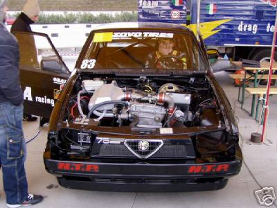

Check this out!
Air to Water intercooler kit for 1.8 turbo 40 litres per minute rated to 300 hp .
what work would be required to fit a 2.0 twinspark 75 motor?
Thanks John

uhhm, I am not sure I follow how we got to intercoolers from gaskets and sealers.

why would you want an intercooler on a T.Spark engine?
We need the intercooler to stay on topic..... ;)
