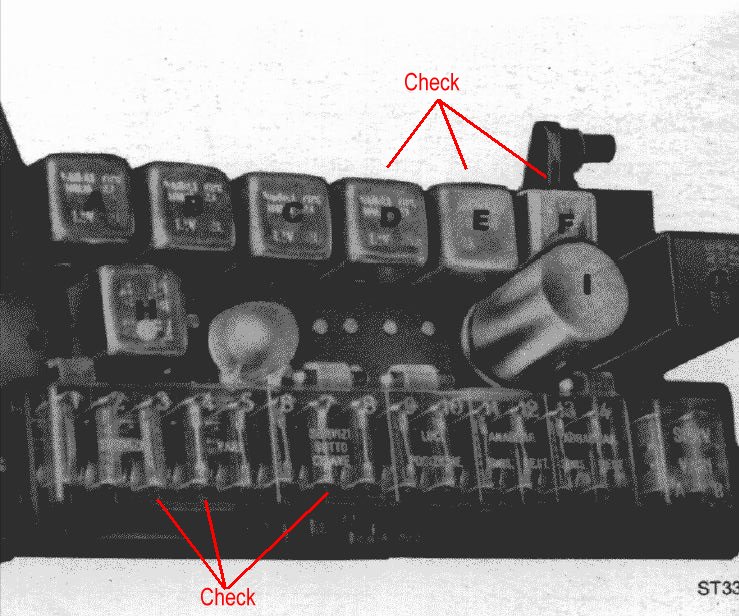

Jim please ignore what I said previously and my diagram.I figured yours was a North American market Alfa and based on your description you definately don't have the "Tropicaire" system.but the car is European (Paris) and it has a shelf under the glovebox.
For the european model you need to check fuses 3,4,& 7 as well as relays 34,35 & 38.See the diagram below.If you are unsucessfull I can give you a couple of names in the Montreal area or if it gets cool enough
- fusepanel.JPG (107.14 KiB) Viewed 13236 times

Re: RADIATOR FAN FUNCTIONS
Murray. thanks you were right on the money. It was the D relay that was malfunctioning. I removed it, tapped it a few times with a screwdriver handle, greased it with some dielectric grease and replaced it. Works fine, but I will replace it soon to be safe. Thanks again and I plan to take a ride out to knowlton this summer. James
