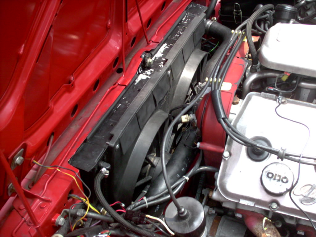

shortlife,
Try this mod for the rad fans. The Alfa's just plain suck. These are from the Maserati Biturbo and can be had from several parts places like Lenny at Autoitalia.com or Joe at maserati compound (check evilbay under maserati biturbo - parts & accessories. It's an almost bolt in swap. The fan assembly is identical to the radiator in the GTV6. 1. Just raise the rad and slip the fan shroud under the rad and drop back down. It is a little tight when negotiating them in as the A/C comp is close. 2. Take 3 sef tapping SS screws and drill thru the top of the shroud & the flange on top of the rad. 3. Swap the electrical connectors to mate the GTV6's. Thats it. Oh yeah, you'll need to remove the sensor connector on the thermostat housing prior to install.
In summer, I've seen the temp at the themostat range even with A/C & sitting in traffic. These fans really suck/blow (whatever) air comparedc the the sh!tty OEMs. I paid about $60 USD + shipping for each of my 2 fan assemblies - one for spare.
- Birurbo-GTV6 Rad Fan In Car 1.jpg (143.22 KiB) Viewed 15065 times
- Biturbo-GTV6 Rad Fan Out of Car.jpg (95.53 KiB) Viewed 15061 times

Brook, great stuff!
What year (range) Maserati biturbo are we talking about?
There are 2 on ebay, but they appear to have smaller motors.
http://tinyurl.com/4dforh
Thanks.
David
Thanks.
David

David,
The rad fans from joedro look identical to my spare set. Ironically, a friend of mine bought the same set up from him a couple of years back for the fans & I chipped in to have a spare Biturbo radiator - win/win situation.
The 1st set installed on my GTV6 have a larger fan motor on the RH side which I surmise is from the 'Tropicaire' edition of the Bitrouble, but not certain. This version had some mods for the 'southern climates' which included wheel rims for more cooling. I wouldn't think either makes a big difference when trying to cool an engine as HEAT is the distroyer of all things mechnical. The OEM fans are also NLA, but who'd in their right mind would want those POSs.
I think these were the OEM fan set up for the Twin Turbo Calloway from Calloway.
Ask what year model Biturbo they're from. BTW, I only saw the fans from joedro and not the other ones. PS - joedroe's an odd duck and isn't too familiar with the Biturbo line, but is a reasonable guy. He actually purchased his Biturbo stuff originally from Louie at DeNoya Trading Place who told/sold me this set up. Louie's forgotten more than we'll ever know.
