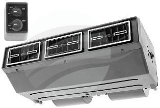

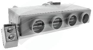

All your front end work will all be for nothing if you reuse the original evaporator/fan assembly. I said from the outset that if you want good air conditioning, you really have to redesign it from start to finish and literally make a new one.
Here are a couple of evaporator units that are of sufficient capacity to do the job. I have used the conceiled type before on an Alfetta. You have to make all your own ducting behind the dashboard and insulate it too. The model EV2208 is available with a heater as well.
If you place it in the middle, you will need to remake the centre console too to shape it so as to make it a neat job. If you get rid of the parcel shelf, that's another possibility.
You can look up the specs. here :
http://www.jayair.com.au/Default.aspx
- Evap unit 18,000 BTU Model EV2206.jpg (29.74 KiB) Viewed 25077 times
- Conceiled type Model EV2208.jpg (20.03 KiB) Viewed 25078 times
