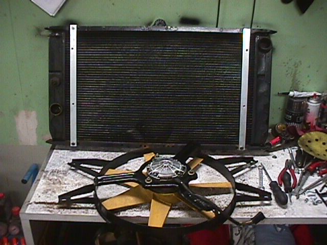

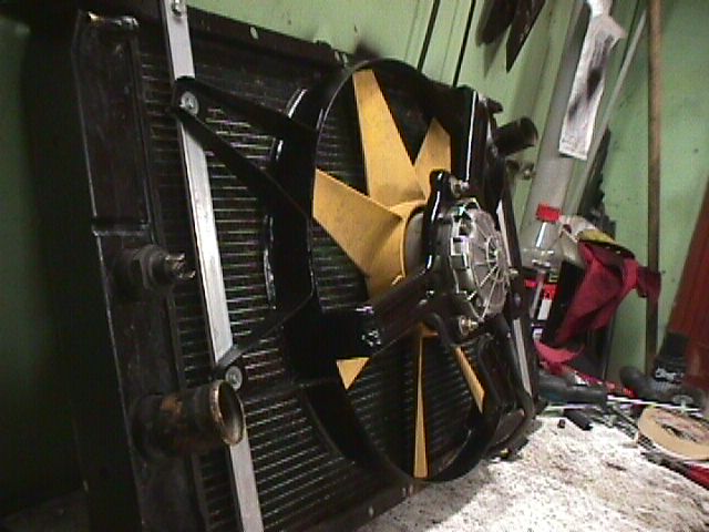

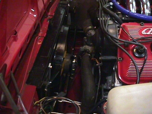

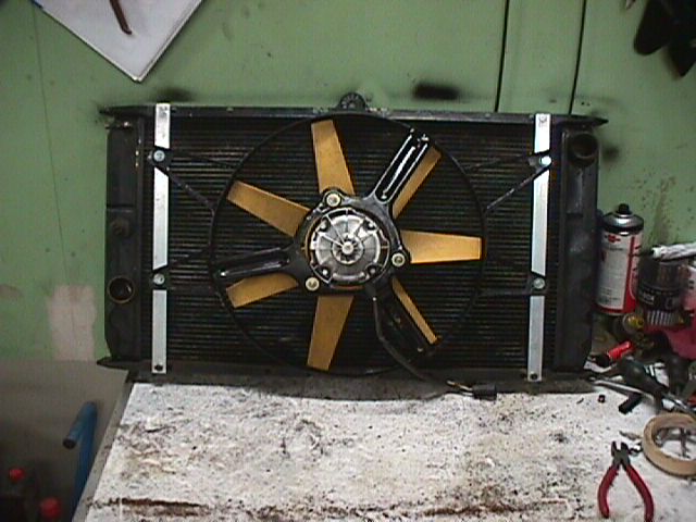

Ended up doing like Dennis. Got a 75-fan and mounted it instead of the twin originals. Looks tight and will hopefully do the job.
Some pics:

Seb wrote:Ended up doing like Dennis. Got a 75-fan and mounted it instead of the twin originals. Looks tight and will hopefully do the job.
Some pics:
Seb, do you now if all 75-fans fit the GTV6, or do I need to find fans from a particular model and engine size?
