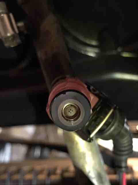

I installed the 832 injectors and the idle is smoother than the 701 injectors. I think my setting with the 832 injectors in the software was incorrect, may have cause that problem where it would stumble. Once I fix my coolant issue, I will put the 832 injectors back in with the correct setting (I think). Also did an engine compression test, all around 220 psi.

For these injectors to seat properly, you need to shorten the 164 or CF2 injector rail brackets. There are 2 brackets per rail. It needs shortening by maybe 5mm or so. If you don’t, it’s possible that the injectors won’t fully seat and you may have vacuum leaks.
