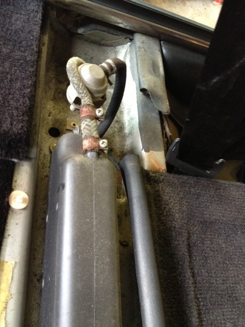

This is not the most obvious but I have seen this problem a few time on the breather tank under the back board where one of the pipes becomes kinked this creating serious fuel smells and also airlocks when filling up . The pipe can kink when some one pulls it to hard from the underside of the car or it naturally collapses from age . A simple check if breather system is working without removing backboard is to disconnect pipe just next fuel sender unit and blow through it .

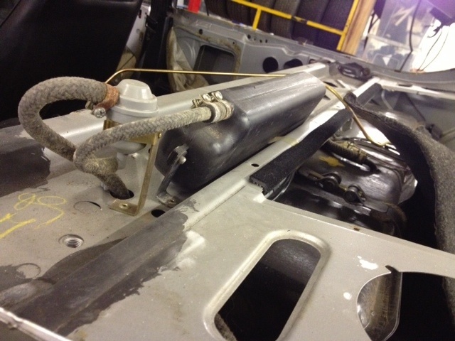

The pic below shows two types of pipe Alfa used and as you can see the black one has kinked . This was probably due to been pulled from underside .
If breather is not working you will also have huge pressure when undoing fuel cap . In the carb GTV this can also cause hydraulic lock in the cylinder if breather mechanism is faulty .
See both types of pics
