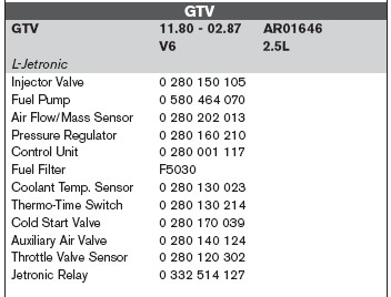

Posted: Tue Jun 08, 2010 5:20 pm
by stonne
Fianlly, Bosch part numbers for various bits of the L-Jetronic system, not sure if this helps anyone.
L-Jetronic Fuel Injection part numbers.jpg (29.15 KiB) Viewed 10550 times

Have a Bosch Fuel Filter in my hand...
Bosch 0 450 905 030
GV
Re: Fuel Pump and Fuel Filter
Posted: Wed Jun 09, 2010 3:56 am
by Mats
GregoryV wrote:Have a Bosch Fuel Filter in my hand...
Bosch 0 450 905 030
GV
That sounds more like a Bosch part number to me (then the other listed above).
