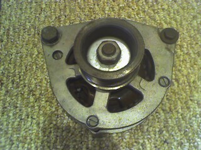

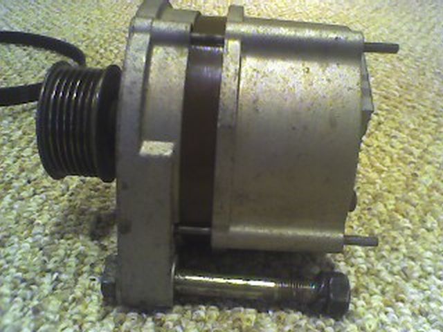

Well I went to the Simon's shop and we checked the alternator. It is not charging and therefore we need to get a new one. Just spoke with Phil and went over my options and we wanted to get some suggestions from others who have done this conversion.
If I remember correctly, we had bought a new 164LS 24V Alternator but the brackets that we had would not fit correctly so we decided not to use the 164LS alternator. We used our old 2.5L 12V and had this installed since it was earlier to fit. Then, the bracket broke and we had Phil make another one for us.
I just spoke with Phil and he said that he did not remember what type of Alternator that we had but went through options on how to correct this problem. I am posting some pictures just to determine if we have the original 2.5 L 12v Alternator. I was hoping that someone could look at this and confirm:
1). It is a 2.5L 12V Alternator.
2). That we have a Flat Belt system rather than a v belt system.

- Alfa Alternator Picture #1.JPG (38.67 KiB) Viewed 6295 times
- Alfa Alternator Picture #2.JPG (23.21 KiB) Viewed 6296 times
- Alfa Alternator Picture #3.JPG (38.52 KiB) Viewed 6294 times

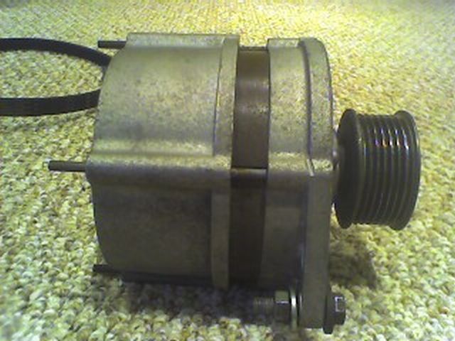

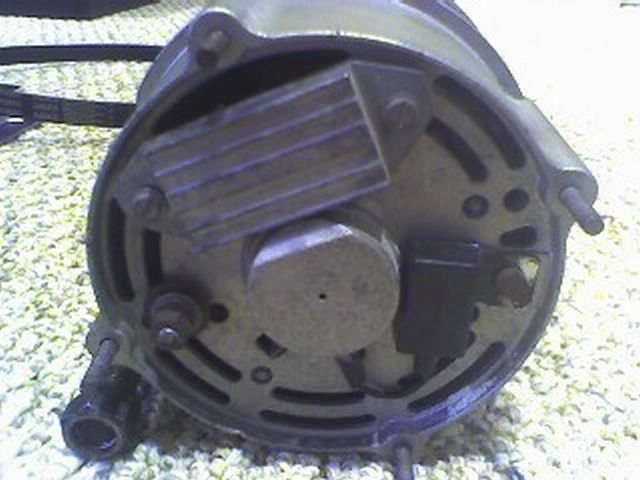

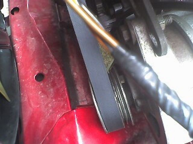

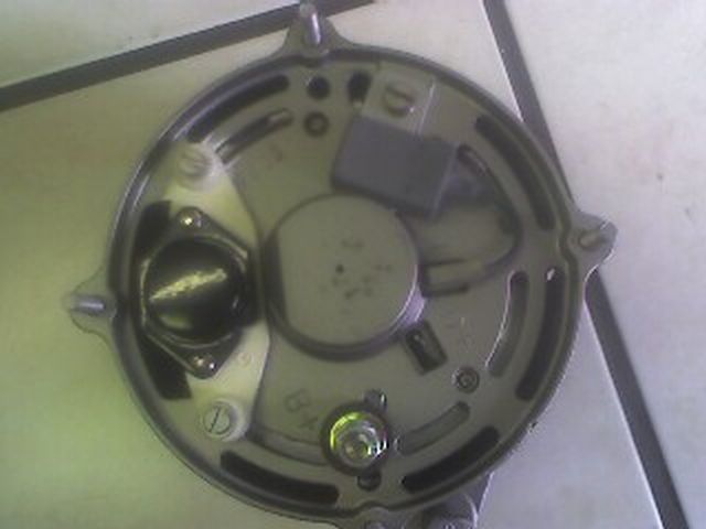

We pulled out the Alternator today at lunch. It was straight foward in terms of the 2 bolts securing it and we did not have to touch the bolt holding our custom bracket. The only small issue was that we needed to partially drain the coolant since we could not remove the alternator without disconnecting the upper coolant hose. Therefore, it is really tight in this area.
We inspected it and there are no markings at all so we have no basis for what type of Alternator we really have. We do know that it should be one for the 2.5L 12 valve and will have this confirmed hopefully by Jim tomorrow. I am posting some pictures of the Alternator showing that there are no names or marks which make this alot harder to figure out what we have. You can also note the pulley being changed from the original V belt to the flat belt system to work with the 164 LS 24 Valve motor. We looked the the original 2.5L 12 Valve engine over the weekend and confirmed that the 2.5L 12 Valve belt system is V belts.

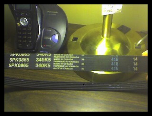

Also, we are posting a picture of the belt for documentation for the belt numbers, size, etc for referrence. We might as well get an extra one now and keep it for future use.
- Alternator 24V conversion #1.JPG (51.19 KiB) Viewed 6162 times
- Alternator 24V conversion #2.JPG (49.42 KiB) Viewed 6162 times
- Alternator 24V conversion #3.JPG (44 KiB) Viewed 6162 times
- Alternator 24V conversion #4.JPG (56.12 KiB) Viewed 6164 times

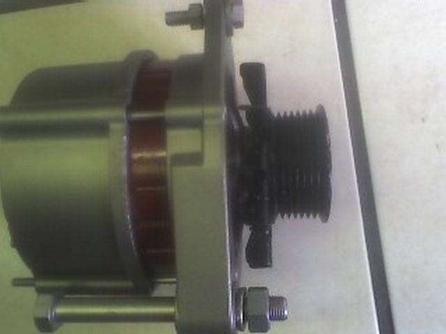

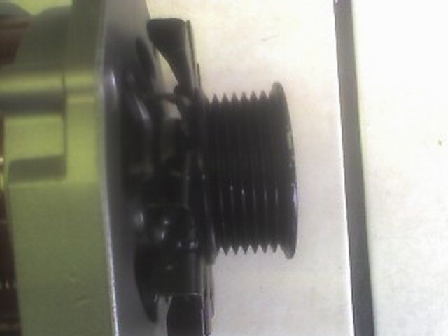

Hello,

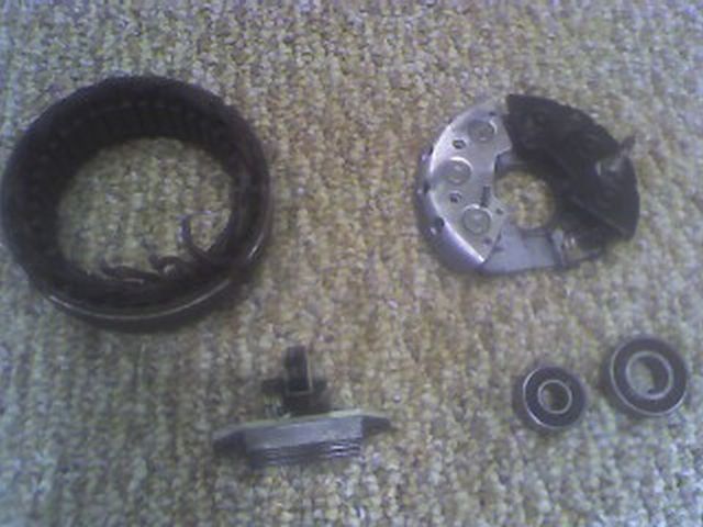

Well we picked up the rebuilt alternator today and determined that the diodes had failed. Most likely it over heated but who really knows. The alternator is close to the headers and it did not have a fan. We spoke with Jeff and looked at the alternator parts just to get an idea of how it works. Here are some pictures of the old voltage regulator, diodes, bushings, and 65 AMP stator.
Besides the upgrade to 95 AMPS we had a new Fan installed and resized the pulley to fit in the same position that it did without the fan. This cost an additional $28.00. We just did not want to take a chance that it would be off 1/8 inch and have the belt not line up. We installed the new Alternator into the Alfa and the Alternator warning light went off. Hopefully this fixes this issue. If the alternator breaks again then we will custom make a heat shield like we did for the starter.
Thanks for all the suggestions and help and we solved this issue.
- Alfa New Alternator #1.JPG (44.42 KiB) Viewed 6071 times
- Alfa New Alternator #2.JPG (19.4 KiB) Viewed 6068 times
- Alfa New Alternator #3.JPG (25.55 KiB) Viewed 6068 times
- Alfa New Alternator #4.JPG (21.09 KiB) Viewed 6070 times
