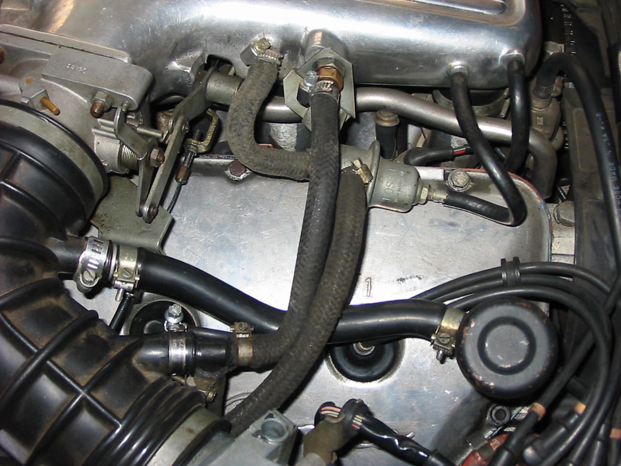

The fuel was dripping onto the top of the middle plug boot. If you have a look at the photo below, it may have been coming from the tube or the throttle body and running down the throttle cable bracket or linkage. I'll check slop in the throttle, gaskets &c...
Alfa 2008 003.jpg (178.23 KiB) Viewed 5656 times
- By the way that was a shot to help me replace all the old tubes, so there is a new set now, except for the intake runner couplers.
If there are leaks that allow fuel to leak out under gravity only, then air can certainly leak back in.
