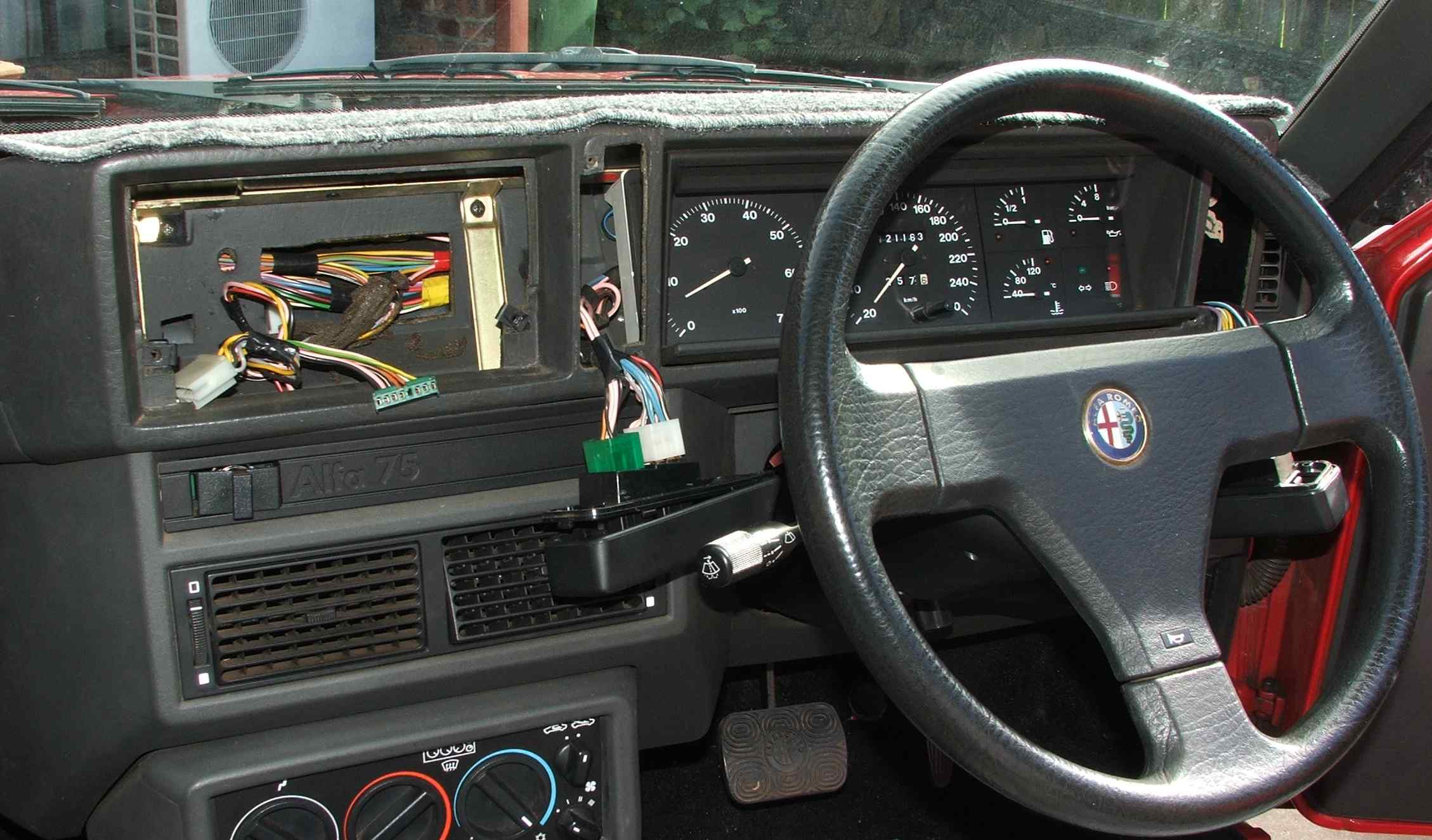

I need to work on the instrument cluster of a 75/Milano but cannot figure out how to take it out of the dashboard.
Got as far as the photo but pretty much bogged down after that.
If anyone knows the procedure or can cut and paste one from a manual, I would appreciate it.
What's the problem? As usual it's a speedo pointer going along for a joyride and pointing at any speed it feels like form moment to moment. The only time it points correctly is with the ignition off !!! :D
75 Instruments Cluster.jpg (195.07 KiB) Viewed 8438 times

MD if you go to"Craig's place" http://www.users.on.net/~craigf/ you can download the cluster and intrumentation manual which will get you there,Good luck.
LHD #@$%*&#!!
I've taken mine out several times but for this I'd need a mirror!
Remove ashtray, remove two screws behind it holding the drawer base, and pull out AR control far enough to remove two main connector plugs. Remove any (2-3) screws holding plated supports to chassis. Remove two similar screws from behind coin holder. Pry loose the two side switch 'pods' (alarm, fog, etc) and unplug connectors, pushing them back through the square holes they emerge from (note which goes where!!). Peep down through the top right square hole and remove the screw you see, finally pulling it out with a magnet rod. Remove the strip nxt to the cig.lighter and undo the 2 screws behind it. You should now be able to wiggle the instrument panel loose, but don't pull it out yet. Tilt it towards the steering wheel enough so that you can unplug the two instrument cluster connectors and the ground pin. You're set to pull the monster out now!
I'm writing this all from memory, assuming RHD/LHD assembly is the same!!
The instruments themselves are held on to the frame with 5 screws, 3 top, 2 bottom. From then on you can work on anything regarding gauges, speedo/tach.

This in dutch and an instruction how to remove the heater, but the green arrows show you also the way ....
http://www.alfa75.info/id315.htm

I got a much better idea now. As I understand it, (more or less) the instrument cluster housing comes away from the main dashboard. After that its a case of removing the instrument cluster itself from this modular piece?
I was originally thinking it would simply pull forward like the earlier Alfetta binnacles but such is not the case !
