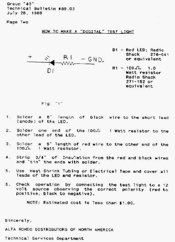

The idea of the "noid" light is not to measure impedance.The injectors turn on/off so quickly (when they're working) 1-2 ms @ idle, that a multimeter can't pick up the signal.So you can either make up a tester (see attached) or get one from your local auto-parts store.
Injectors are supplied a constant +12V by the comb-relay when the ignition is on and the injectors are switched on when the L-Jet ECU creates a signal path to ground based on input from the distributor hall or variable reluctor sensor.
So what you need to do is turn on the ignition and confirm that you have +12V at the connectors for the missfiring injectors.Next use the "noid"light between both terminals of the injector and confirm that the LED pulses when the engine is cranking or running.If it does then the injectors are getting the appropriate signal and are not delivering fuel because they are blocked or faulty.
- DIGITESTLIGHT.jpg (49.38 KiB) Viewed 8428 times
