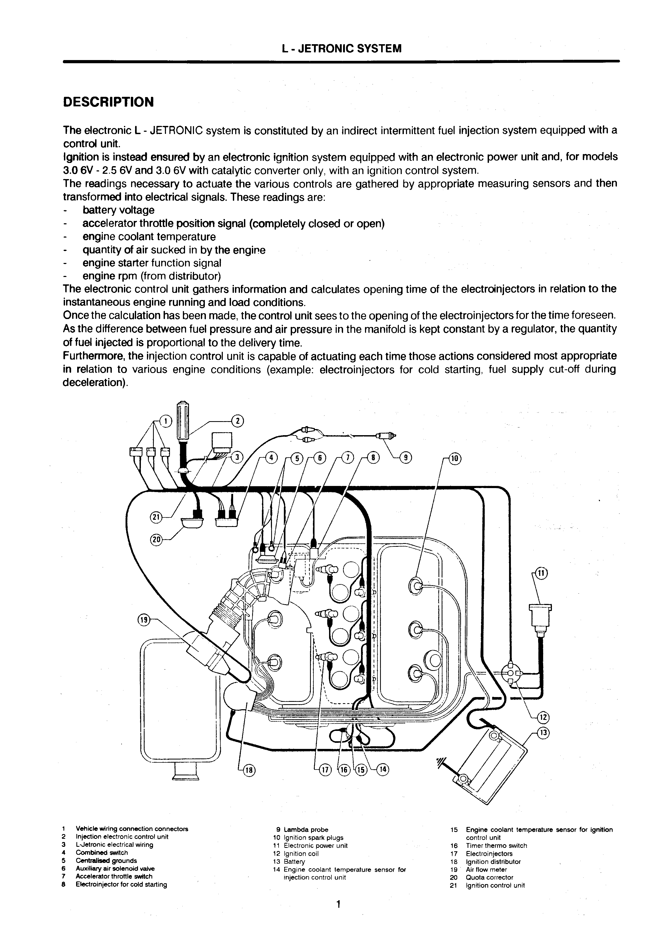

What is terminal 1 on this picture?
Here is link for picture if attachmented is not clear enough
http://img259.imageshack.us/img259/269/d001ce6.gif

Barry wrote:Do you have terminal 1 connected to the ignition coil?
This allows the ecu to pick up a trigger pulse from the coil so it knows when to fire the injectors..
Its normally a pigtail connector close to the rear of the distributor side head having a spade connector and the shield having a 6mm flat lug connector.The spade connector side should be extended to neg. coil or No 1 terminal on the coil..
Yes pin 1 on Jetronic is conected to ignition coil, but no pulse from ECU to injectors :(
