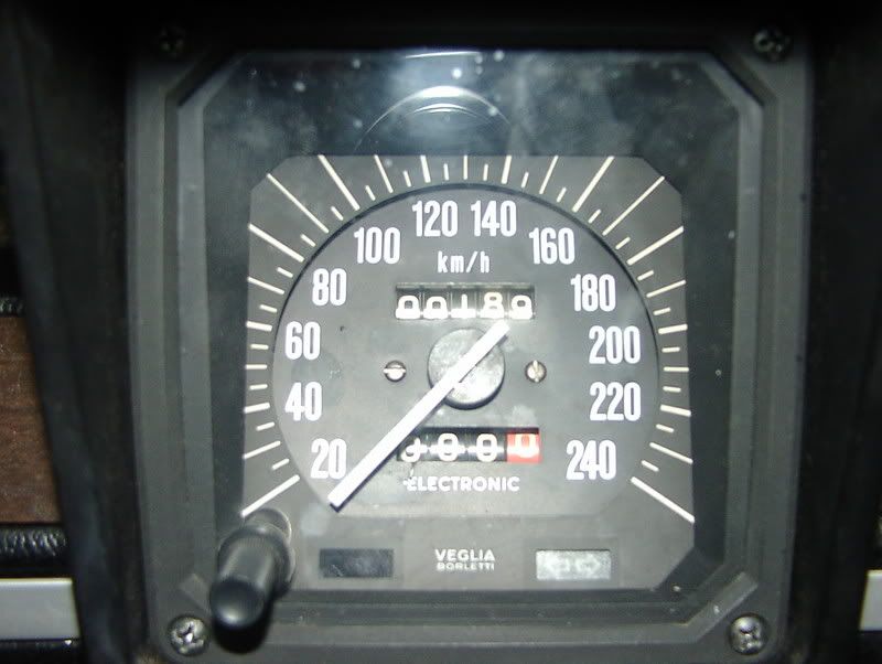

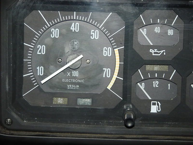

My '84 GTV 2.0 needles were looking VERY second hand, the previous owner had snapped the speedo one and had glued it back together but it had a rather serious bend in it. Also the tacho one was a lot shorter than it should have been plus was covered in what looked like white out!!
Anyway since the temp was in the mid 30's today i didn't feel like doing any engine work so I re-furbished my needles instead I simply cut off the locating lugs off the backside of the needle, pried the needle off and replaced it with some U-channel styrene plastic. I am quite happy with the results as they look as good as new (ok i know they are not triangular in profile like the originals but the look a lot better than the ones that were on it) before and after pics below.

The needles are actually a three piece assembly, the actual needle (white bit), the black circle which has a grove in it where the needle goes and a metal counterweight inside the black bit. The needle has two pegs which stick through the black bit (one also goes through the counterweight) and they have the ends squashed to keep them from falling off. All i did was carefully cut off the squashed bits, pop the needle off and glue the new ones on with super glue (also remember to put the metal weight back on the right side) and bingo, nice new needles.
