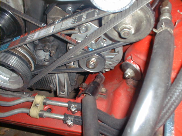

Hi Rob,
I don't understand everyone's fascination with the 164 alternator. Sure it's from another Alfa, but so what? Bosch is Bosch, what's the difference if it's from another Alfa or some other car. The only difference I can see is the Alfa units are really expensive and hard to get. When you are on a long trip and your alternator quits you are no better off needing a 164 alternator than you would be needing a Milano alternator. In both cases you will be stuck in a hotel while you wait for a replacement to arrive.
The way I see it the BMW 735i alternator is the way to go. They are cheap and you can get them at any autoparts store. It takes some work to do the initial conversion but once it's done you have an inexpensive easy to replace unit with plenty of amperage.

Here is a picture:
I did try to get my dad (who has done this twice recently) to write up some instrucitions, but neither he, nor my wife (who runs the website) seem to think it's worth the time.
Here is a picture:
- BigAlternator.JPG (59.38 KiB) Viewed 12926 times
Greg,
To be honest, I don't care what car its from, I've just seen on this board that somone has completed a 164 conversion with some modifications. I do wish someone had a procedure, because I do think its worth while. I have never been a big fan of the alternators in these cars. A more readily available alternator would be fine.
What year 735i are they using? Whats the output on that Bosch model? It's hard for me to see what modification was made from that pic, was it a new bracket? That pulley looks a bit smaller to me for some reason, maybe i'm not remembering what the front of my alternator looks like.
Thanks,
Rob
Thanks,
Rob
Hi Rob,
OK, this is from memory and I can't check with my dad right now. I think there are actually two 735i units and he used the higher of the two. It's around 100 amps. The 735i was made in two models the E23 and the E32, they both use the same motor and I don't know what year the alternator was upgraded. In fact it may not have been related to the year, perhaps it was related to other options, market etc.
The pulley only looks smaller because the alternator is bigger. It's the exact same pulley, you re-use the pulley on your existing alternator.
