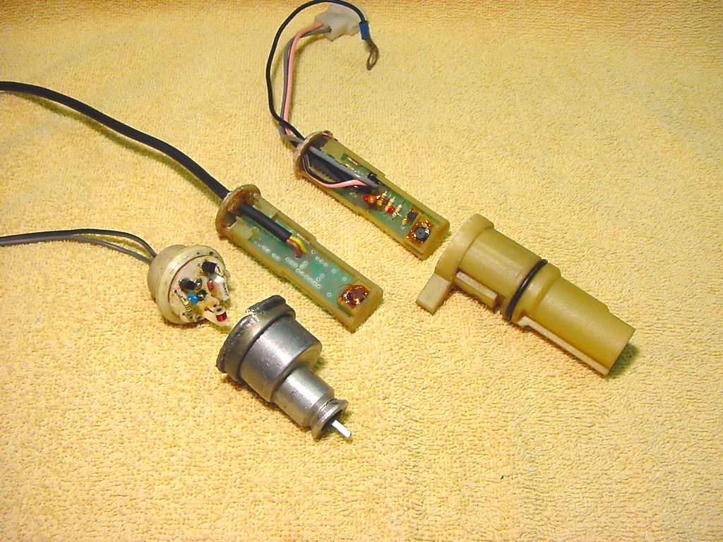

Here is a bit more help.
You can fit a mechanical speedo head, drive cable and power it up to work indicator repeater lights and back light provided you can satisfy the following:-
1 You are happy to have a blue dial plate instead of black and white one.
2 Your original "round" Veglia sender looked like the one on the bottom of this photo. (imagine it together of course)
If it does, the mechanically operated speedo head will work. If the senders are anything like the others in the photo, it will not work unless you take the gearbox apart and make some modifications inside it which I will not describe here to keep things simple. If you need more clarification, send me a PM.
- 3 Sender Interiors and covers.jpg (144.83 KiB) Viewed 14993 times

ι am very pleased at the fact that quite a few people are helping with this speedometer problem of mine. Anyway MD: my sender looks exactly like the round one in your picture but i'm afraid my speedometer is the one used in GTV4s instead of GTV6s and i definitely know these two are sort of different.
On the other hand there are differencies in the numbers that are on the round senders as well.I' ll try and get some numbers tomorrow.

Mate, on a more serious note understand this:
All 116 GTV speedos work the same not matter how they may slightly look different except the mechanical one on the early series. They respond to the same type of signal once they get it.
What is different is that the signal sources vary causing all the drama that people have of making things compatible if they change transmissions.
What to do?
1 Get an original Veglia sender not a Jaeger and install in gearbox.
2 Install a replacement Veglia speedo head from any GTV.
Now how simple is that? From what I am reading you are saying, you are doing a frantic mix of this and that not having a real handle on the problem. Stop.
What to do?
