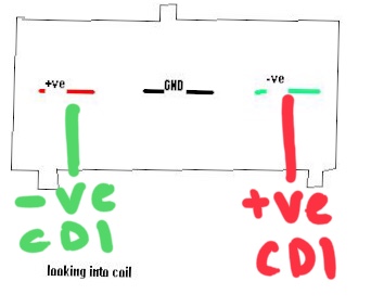

More info on the coil pack wiring. :D
Screen Shot 2019-10-04 at 10.11.26 am.png (170.19 KiB) Viewed 14380 times

As per Beninca

Alfaaa1, your hand drawing is correct for the factory wiring. Trigger goes to one of the 6 ignitor transitors within ECU, centre is earthed to the head (or wherever you ground it), 3rd pin is fused 12v and only on when ignition is on.

Alfaaa1, both SteveR and 75evo are correct. You original drawing is capote the for what you want. (Transistor type ignition, controlled by the ecu) evo75’s drawing is also correct in that with a Cdi you reverse the polarity from the Cdi into to the coil. But you’ll notice in his drawing the positive of the coil goes to the neg of the Cdi. Which also correlated to your first drawing of the orientation of the pins. Yes the centre pin is direct to earth.
