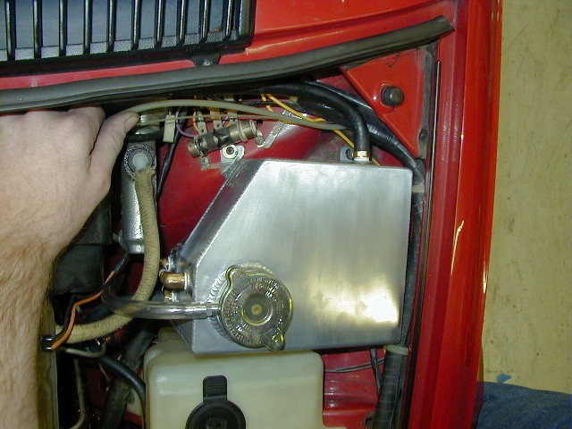

Looking at the picture here below, can someone tell me what is the purpose of the resistor placed next the cooling expension tank ?
Thanks a lot and best regards.
What's this for ?
- Rear%202%20Mounts.JPG (87.25 KiB) Viewed 4115 times

Billy that is the blower motor resistor.It drops the voltage in switched increments to control the interior fan speed.

On my car, the three wires that we can see on the picture are effectively there but no resistor is mated to it and the vent system works well (at all speed).
Is it possible that these wires are reserved for US version or for cars equiped with air conditionning ?
