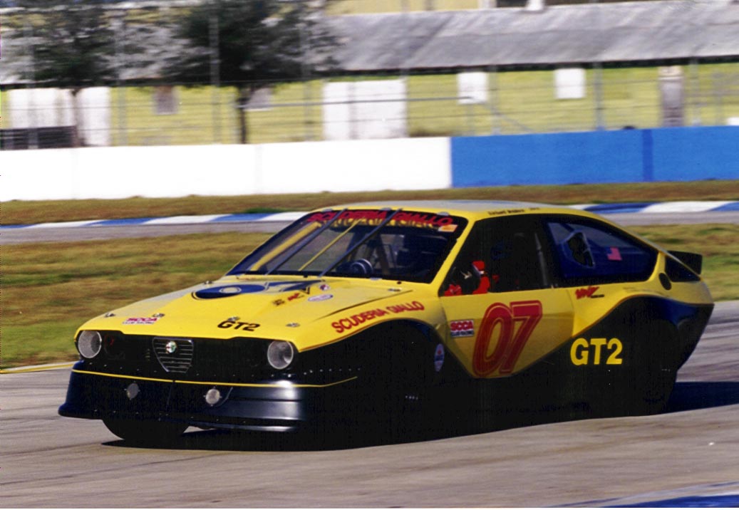

Cheat!! I'm sure your competitors are totally legal <wink><wink>Micke wrote:So, the same questions still applies
- what are you allowed to do (Beryllium DeDion??)?
- how much are you willing to spend (the DeDion mentioned above will NOT come cheap)
As a wise racer once said, "if you race to be fair, you'll learn a lot about tail lights".
Said racer was very successful in a 2.5 GTV6 in SCCA GT2.
-Peter
- jemison.jpg (95.38 KiB) Viewed 15324 times
