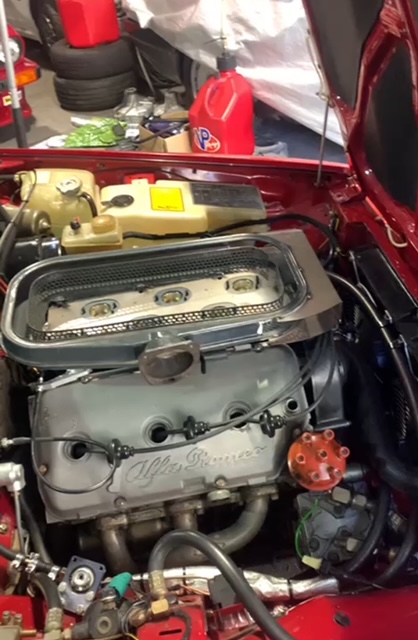

I think to do it right, I'd need to fabricate something like this:

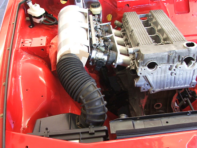

Here is a set I adopted from a Hyabusa motorcycle form my Twin Spark 4 cylinder racer almost two decades ago. Plenum closely resembles finished article.

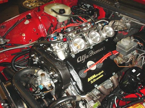

The owner himself said with the 24V and typical 156 plenum he only had about 215 whp. After installing the AHM kit, there was a huge jump. Take that statement with a pinch of salt, but there was definitely a big improvement.

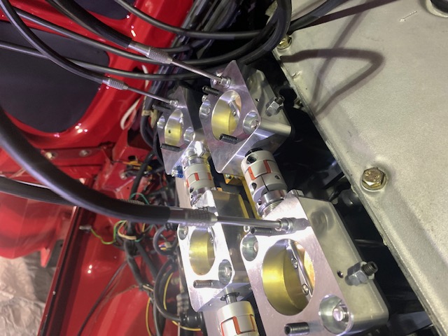

Hi , Michael . The torque with carbs and throttles is superb on the 12V . A friend of mine and I have have spent the last year and a bit making throttles for the carb 3.0 SA GtV that’s a direct bolt on application , including triggle wheel , and all brackets. Original airbox fits on top . This is not what you looking for as this is for the car heads which has different casting.
Full credit goes to my mate Stavros for spending the hours and hours revising this down to every millimetre. This kit is specifically for the Carb owners who merely just want to slide the carbs off and slide this kit on.
I can what’s app you some videos of this . Now on another note there are many ways to do filters using the AHM throttles and keeping cold air ! Give me some time and I will send you some pics

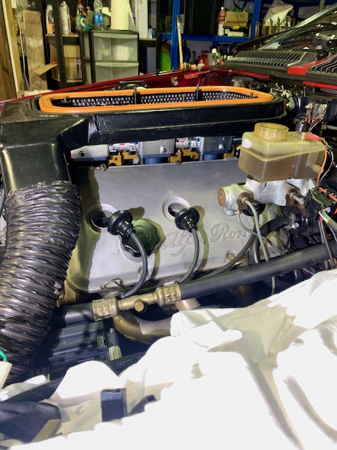

Some pics with original airbox on . Note the SA GTV airbox is extended over the original Sei airbox . The trumpet look was just for testing an provisional mapping so can get to all adjustments.

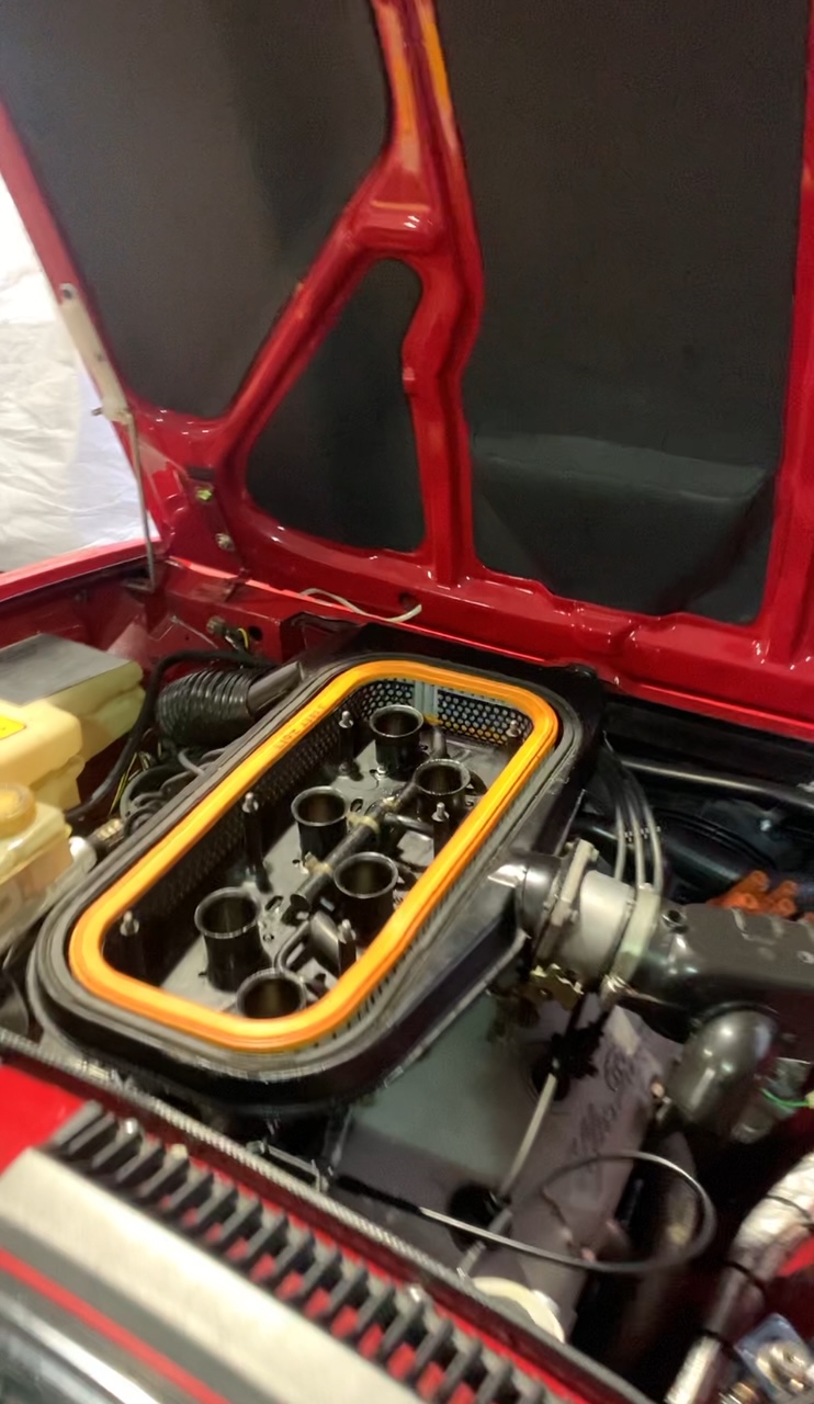

More pics

If airbox you talking about then you can use the original airbox .
As in the photo above . Or you can modify an original airbox and incorporate much larger trumpets like I’m doing . Does this answer questions
