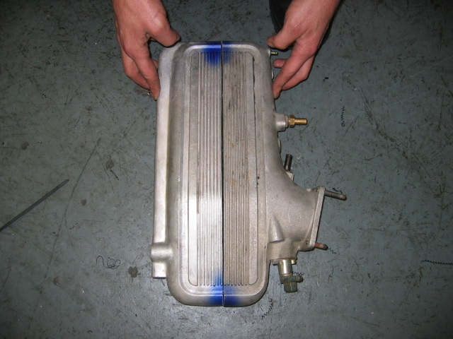

I would probably go with the shorter runner as the 3.2 has huge amounts of torque . But I prefer modified the side plenum anyway as you can really make a huge chamber and get an even airflow to all the pots with far less effort .
Are you gonna use the double plenum from 2.5 cut in half and joined ? I have tried both twice and its huge work the double plenum . Having said that my third attempt would be even shorter runners and increase the height in the 2.5 plenum by another 20mm . This would really be good . Unfortunately the 2.5 bonnet gets very close .
