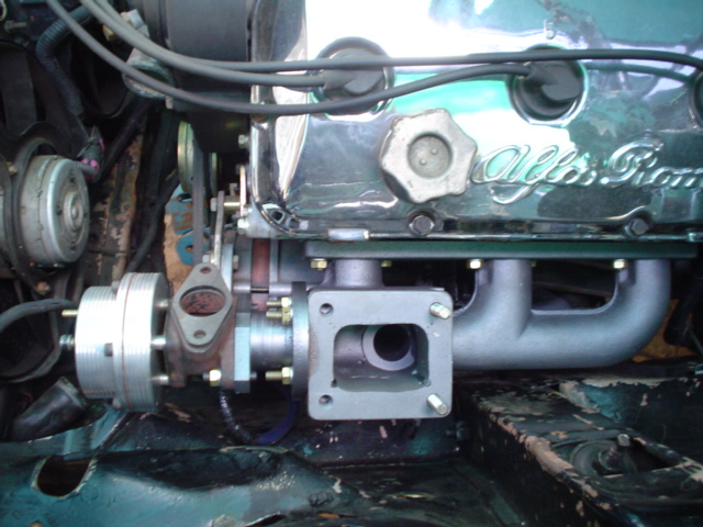

Few pics of single turbo install-Barry
Single turbo,cast iron manifold,custom made on the other side as who ever installed this damn engine moved it back 6cm and dropped it lower.. :evil:
Made for a hell of a lot of extra work..
Had to extend the wastegate..originally ran Audi wastegate on here..
Custom  LHS manifold..grrrr...
Xover pipe under the engine..<br />double slip joint does the trick here..

6 Speed Gertrag BMW box(one of the gears is a bit backwards.. :wink: ) on a six sedan diff..whats more to say...
Thanks Greg,pity about the rest of the chicken coop...I normaly use a std manifold on the rhs side...makes for easy install.. :D

Its a small valve 2.8l..single turbo in a Giulietta..front mount box,diff rear..
0.7Bar boost,240 wheel hp..
Things get a bit tight with all the plumbing an stuff..Will put pics up as I progress..

Greg,Ive done close to 17 of these single conversions..Most are still running today..Im doing 4 more at the mo..
Ive had one cast manifold actually crack..the reason for that was the owner chabged the wastegate and fitted a solid wastegate exhaust that tied into the main downpipe..No flex pipe in between!!.This put tremendous strain on everything when it all expanded with heat and the manifold cracked..
This was after 2 years in operation mind you..
This particular setup is very custom..With the motor so low and so far back,Ive had to take the wastegate exhaust UP and over as you can see..Usually that all runs down and next to the block and via a flex joint into the main downpipe.
Much neater that way.
Ill do pics on the next 3 I do,those are all std.
F,Ill get a pic up of the car soon for you..
Plats,Ill use 450cc injectors with a "Dicktator "management system here..Ill use the std dizzy to trigger it all.
At 450 cc the injectors are just right for this setup..Gives you that safety margin as well..
Remember that the boost is kept relatively low as I use the std cast piston in here..
At 0.7 bar they all make about 240 wheel hp..Thats plenty for a stock car where you want a bit of extra zing..
The nice thing is that all the other components remain stock and can take the extra power..So its not a bottomless money pit while you waiting for the next component to fail..
