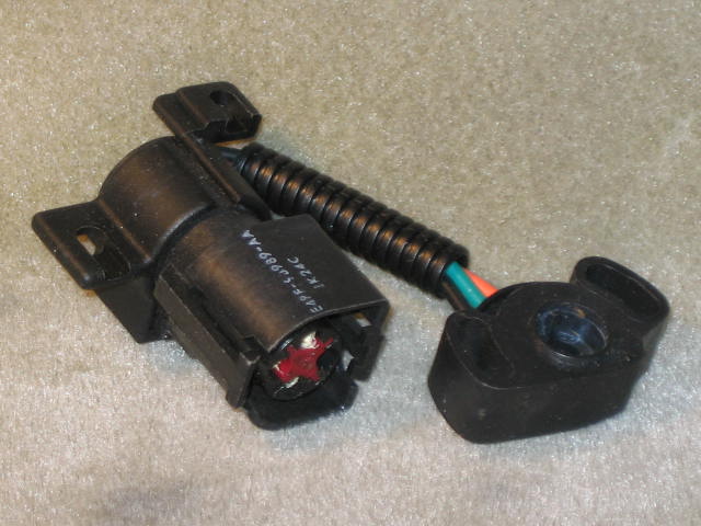

What kind of output shaft (the shaft on which the throttle disc is mounted) end is there? Half moon? How far does it stick out? These criteria allow you to mount different TPS. You can also make new shaft to fit another style TPS if needed (more work)
I used old stle GM (like Ford Mustang) three wire TPS sensor (cheap and very available) with great success but with a Haltech unit....
What about the OE TPS from a 164? Not a pot? Maybe a cheap used BMW unit will have same mounting holes and less pins...

I have the GM unit like X-rad's with my haltec, works fine, you have to fabricate a simple 3 holes- alloy bracket.
