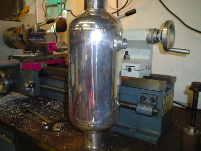

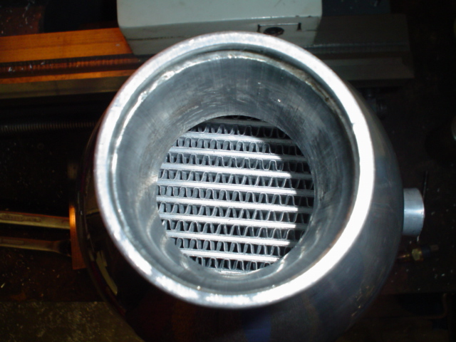

Home made..6" x 15" long..Lovely internal core..fitting it to the 20l turbo nobody is interested in...
Chargecooler,sir??-Barry
- DSC00145.JPG (146.89 KiB) Viewed 11594 times
- Zuke bomb....be afraid,be very afraid....
- DSC00146.JPG (148.89 KiB) Viewed 11595 times
Dang! Now that´s what I am talking about!
The fabrication there is beautiful. Did you make it? If so you need to start producing them in different sizes. I am going to need somthing similar for my SuperSpider project.
A 6x15 inch barrel is a huge amount of cooling capacity, you must be planning something really serious.
It works like this. Air flows through the fins, coolant flows through the section between the fins. The coolant is pumped through the intercooler and up to a little radiator, usually at the front of the car.
Air transfers its heat to the coolant which then is released at the front radiator. It´s a very effective way to reduce charge temps, and is generally much more effective then a air to air intercooler. As an added bonus the coolant can be circulated through a dry ice packed container for insanely low charge temps at the track.
