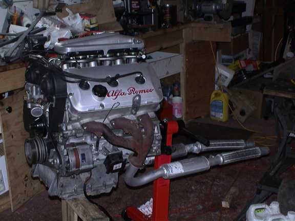

Spike you don't have to worry about excessive volume with the Ansa.It is just fine for street use.
To replace my cat I used AR european standard downpipes which consist of a small resonator and a flexible joint.They don't come with provision for an O2 sensor so I welded one in.I am very pleased with this mod.Fortunately we don't have emission testing where I live
These pipes can be obtained from any AR parts distributor as they are used on all non-cat European GTV6's and Milano/75's.They do require slight modification to fit N.A. factory cat. cars as follows:
-shorter manifold bolts because N.A.cars had a spacer between the downpipe and manifold to lower the exhaust so the cat.would fit.
- 3" extension welded on the ends that meets the center exhaust section which is shorter on cat equiped cars.
