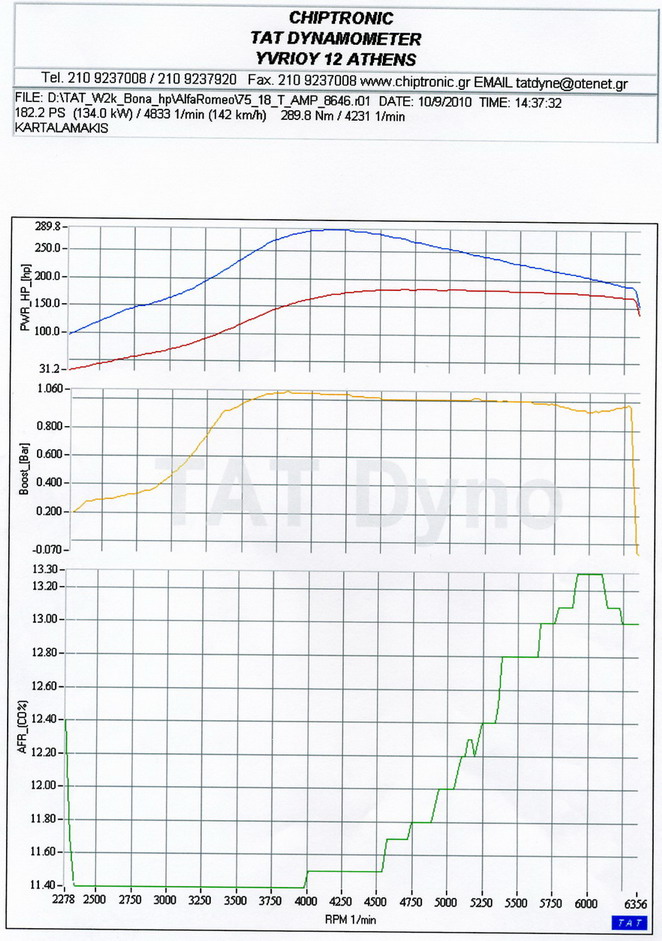

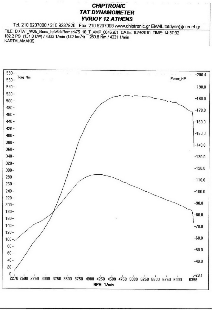

Today I put the 1.8T road car on the rollers and with 30*C ambient it showed 160whp (translating to ~180hp flywheel) at 4800rpm and a bit over 290Nm at 4200rpm. Mods:
8:1CR (up from 7.5:1).
2-piece special head gasket.
1bar (14.7psi) chip -all this does is decrease advance so knock is reduced, allowing more boost by not actuating the wastegate through the infamous Pierburg valve.
10548...intake cam.
Evo cast iron manifold.
63mm exhaust.
JK210 CD ignition.
Boost set manually with bypass valve at exactly 1bar (14.7psi) and comes in at 3300rpm with the std ancient snail.
AFR is a bit rich (11.4) up to 4200rpm and then weakens almost linearly to a dangerous 13.3 up to 6200 cutoff. This can very well be a sign of a weak fuel pump. All in all I'm satisfied as road performance is excellent all around for a daily driver. In the next few weeks a much better and responsive snail will go on and another measurement will be made.

Re: 4-cylinder turbo performance
I found out that my injectors went to 100% duty cycle at around the same revs as where you experienced the leaning out. Stock stuff.
Hmmm, I was under the impression these (0280150152) were 340cc injectors but apparently they are 240cc. Rough calculatin shows ~230cc are needed for 190hp, so you may have something there Mats. Since I want to keep the std looks, I'll have to find similar style injectors with about a 260cc rating and fool around with the pressure a bit...I will also replace the pump first with a higher rating one first, since the std one is on its way out (squeals a lot).
JimGreek wrote:Right, that's the pump I have in the other 1.8T. For those interested, the full Bosch part number is 0580254909. They go for ~105€ here. I just hope its the pump and not the injectors going static.
I measured mine with a small adapter harness in between the injector and engine harness, a multimeter with the option to measure duty cycle did the rest.
No more guessing. :)
Yes, its the proper way to check it. My DMM doesn't do this. Maybe I should ask what they go for; at the going prices they should be in the 40-70€ range.
17 euro... and that's what I found in 5 minutes...
