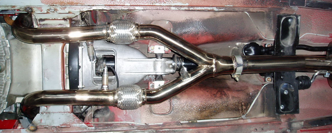

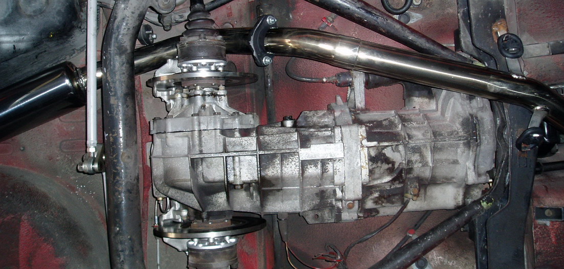

Here are a couple of pics of the exhaust system. Both mufflers are of the oval type and the sound is very proper, contained and deep, not in the least offensive to the ear or anyone nearby. Note that the chassis is a 1st series 1.8T with the gas tank under the trunk floor next to the spare wheel well.
