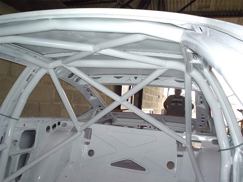

OK off topic again :lol: Micke for the rollcage, in the back section is there a rule (let say for your racing organization) which says the bar from the main hoop to the rear section of the car has to be straight? Or can it be slightly bent/curved (kind of like JimGreek's cage) so I can have more room in the rear? I didn't see any rule like that here.

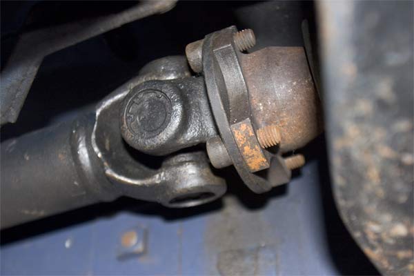

ar4me wrote: Andrew,
The only change to the drive shaft is the addition of the "plate" at the front coupling to reduce the "twisting". Again, we'll see if I'll be changing couplings daily...
Oh, and I have an inherent weight advantage against JJ (the secret: running daily). :wink: Though, can't match Zamani :wink:
Jes,

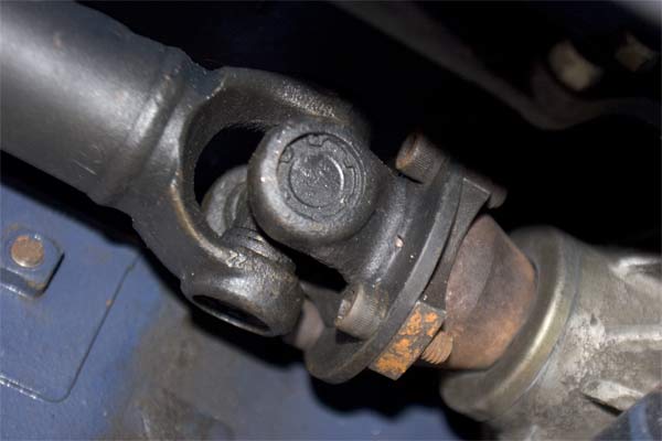

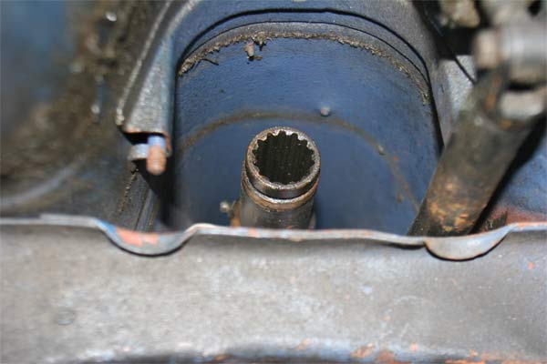

You need to get some of these..... Solid prop u/j - proven with big power/torque. Also notice the extra beefed up webbing on the Autodelta factory clutch cover - another weak point, with high revs and power.

I'm not sure about the cage but the front tubes are often bent for clearance. I think it's allowed. Stiffness will suffer of course. The diagonal bar is always straight as far as I've seen. This you can make removable if you need transporting power.

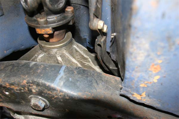

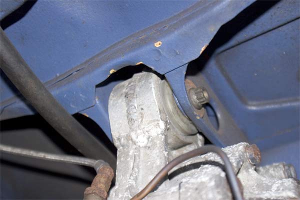

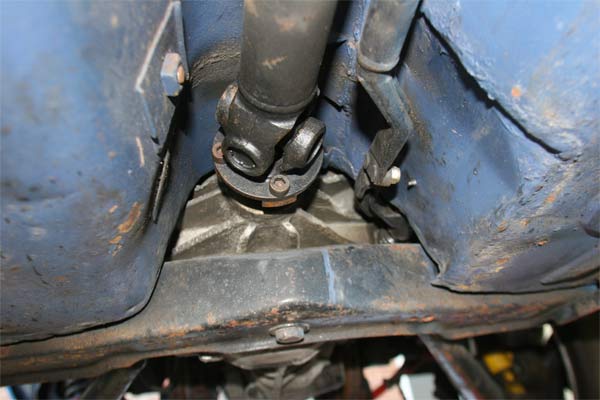

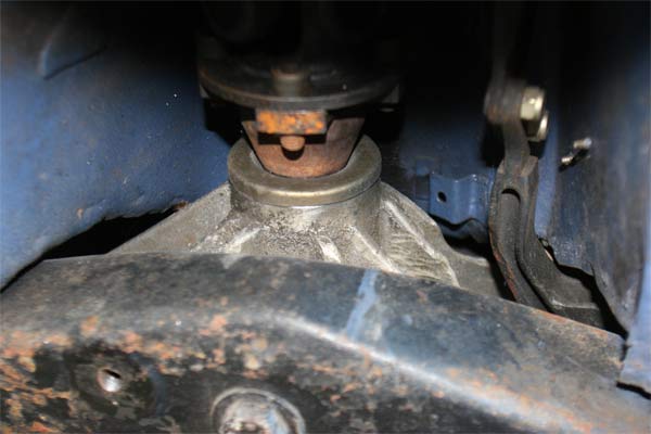

Some more solid prop, and re-enforced rear g/box mount - with nylon bushing. Group shot of my fast fleet :D

Are those pics from your Rouse GTV6? What do you have in the center, or is it a one piece solid shaft?

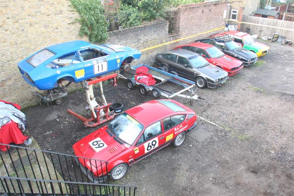

Thanks Zambon
As follows:
Ex-Andy Rouse Touring car '11' (1983 btcc overall winner)
Anthracite South African GTV6 3.0 carbs
Black GTV6 2.5 Original spec 36,000 miles
Red GTV6 fast road/track days with 24v motor, soon 3.5
Alfetta race car - 1.8 hot turbo motor
Red Twin Turbo 3.3 24v GTV6 '69'
Hidden in garage '65 Giulia Sprint GT ( supercharged T/S one day)

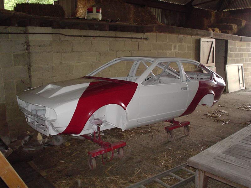

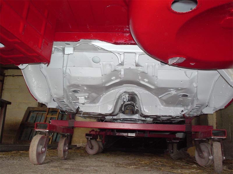

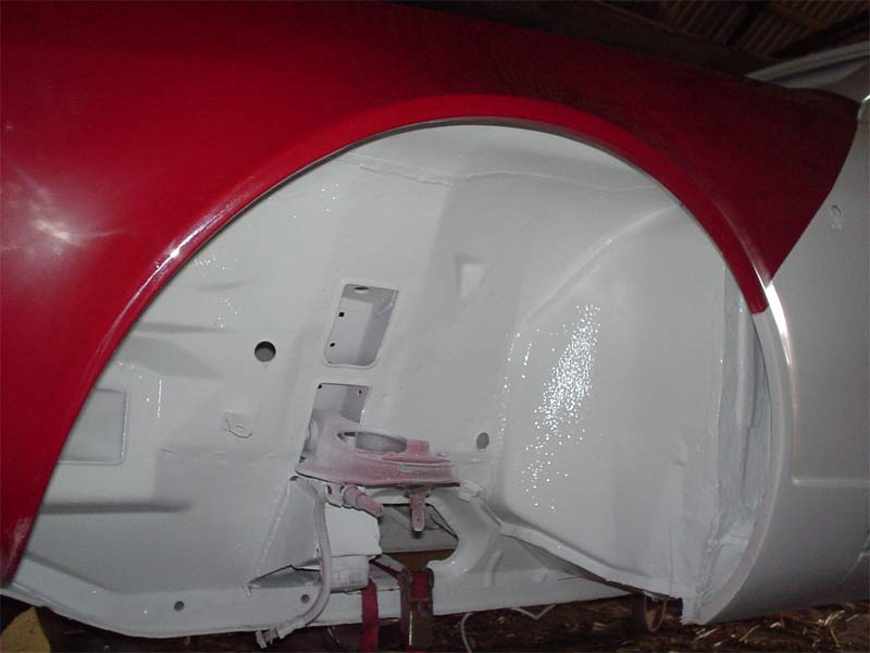

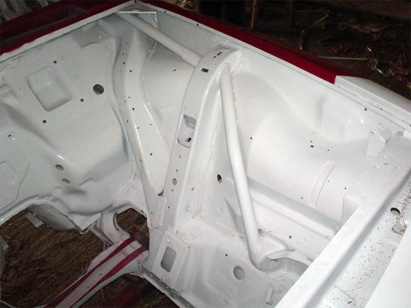

Hidden at Alex Jupe's w'shop - Red/white Snobeck racing european/french touring car 1984- mmmmm see the following restoration pics
Sorry for trashing the thread - just love modified race/track cars........ like Jes's
