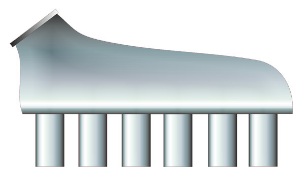

Re: Inlet Manifold Design
Back to track..
Mats, what do you think of this design?
- 6c24v.jpg (43.35 KiB) Viewed 16445 times
looks nice, needs more width outside #1 and #6 though.
