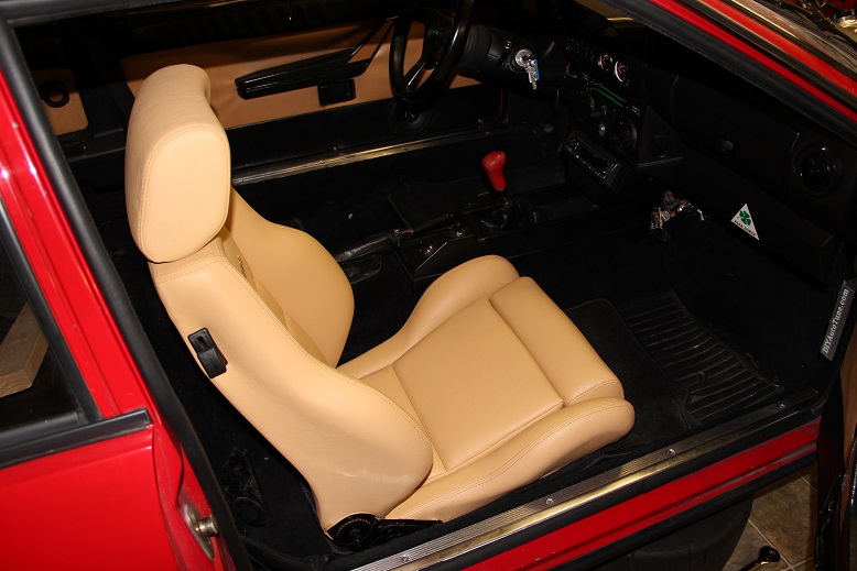

Lastly the seats - it took the upholsterer a long time to finish them, but I must say that they look brilliant & it was worth the wait! Nice work Ron!
I'm having the rear seats done to match.

The seat is simply amazing.
