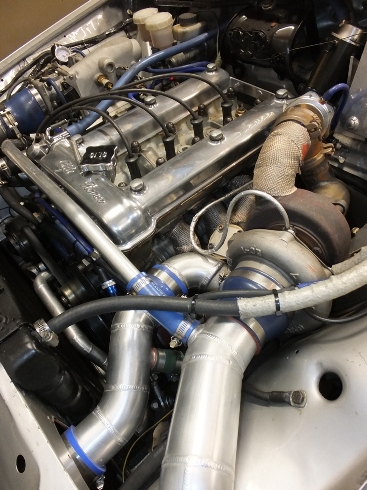

A pick of mine.

A pick of mine.
- DSCF2823.JPG (163.63 KiB) Viewed 18053 times
